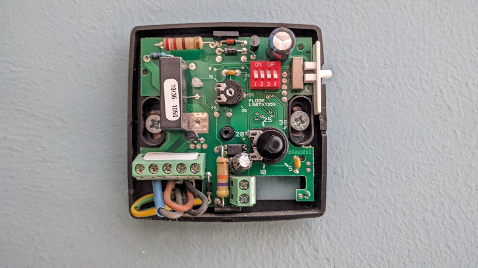

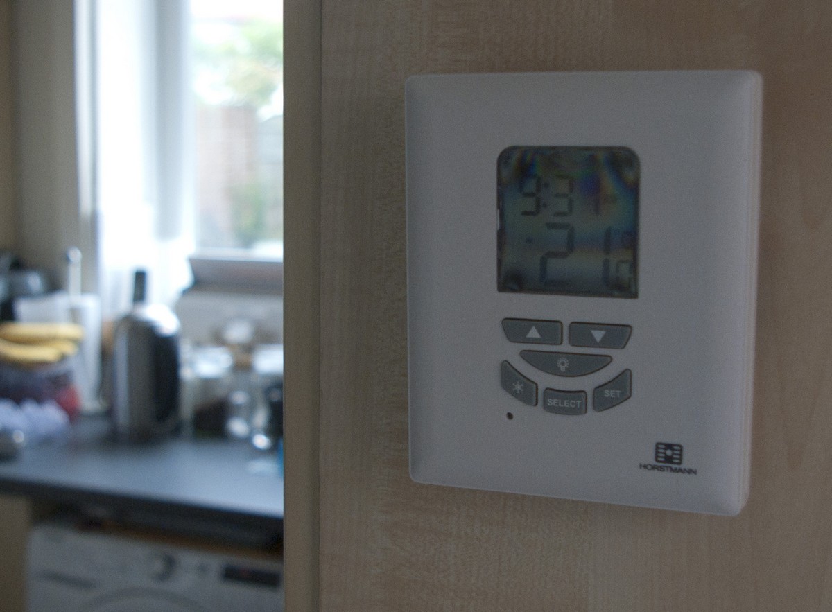

I'm planning on swapping my dial type thermostat with a programmable version, likely the Salus SQ610.
My set up at the moment is that I have two dial thermostats, one for the rads and one for the UFH in the kitchen which is the one I want to switch out. The two stats go to a controller which also handles the HW.
If I simply swap the thermostat to the programmable version would I leave the UFH channel as permanently on and let the new thermostat control things or will I also need to change out my controller?
I should mention all current controls are Continental / Continal and the Salus thermostat seems to be sold as that brand too so have assumed any compatibility should be ok

To answer part of your earlier question, yes you could leave controller set to permanently on and let the thermostat settings take over.

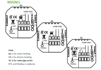

But the scene has changed Moes, Tuya and many others are so much cheaper than the traditional makes we have seen in the UK, the one I was looking at there were three versions one electric, one for UFH and one for standard boiler, last two letters say which is which, but when you can get a smart thermostat for under £50 one has to ask why pay £250? I did a google for "smart thermostat tuya for boiler" and there is one that looks just like Nest for £45 unlike nest it needs a back box etc. But I have had my Nest fall off the wall when some one slammed the door.

In this instance I'm only looking at a hard wired programmable type for the UFH. I don't touch it most of the time and heat changes are so slow I don't need it 'smart'. Frankly it should have had a programmable one fitted at the outset but we live and learn with builders!

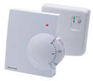

As I don;t want to cut into a solid wall to have a recessed 'flush fitting' type I'm just looking at the EPH CP4M that @ianmcd suggested as a brand, or the Honeywell T4. They look to have same functionality so if anyone has a better experience over the other, or a reason one is not suitable for UFH I'd be happy to hear it.

The eph stats are fine use them regularly cost effective 5 year warranty good kit.
