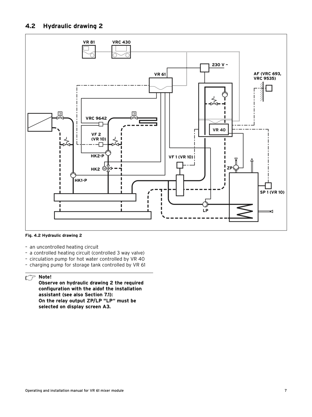

Well on the face of it it appears the right kit was bought for starters (the VR61, two zone, is quite an expense over a single zone controller), but was never implemented properly. That’s a real shame. You can run it with a manual mixer, but you probably need to rewire the VR61 to zone valves for each circuit (HW, UFH & rads) and fit two sensors (VR10) just after the valves. This should have all be done at the start. If you’ve got the VR61 installation book, your layout is in there.
It shows a low loss header and zone pumps rather than zone valves, that’s the German way, but on a medium sized property should work ok using just the boiler pump. Do you know your Heating load requirements, house size or even how many rads you have. I’ll list those changes at the boiler to at least help something.
Do you know your Heating load requirements, house size or even how many rads you have. I’ll list those changes at the boiler to at least help something.[/QUOTE]
Top of my head, we have 16 radiators, 1 which runs direct from the boiler in an ensuite. Sitting room has UFH/2 radiators & Study/downstairs office which is open plan to the stairs is UFH. Do you have an email address I can fire the house plans across if that would help as tbh, I haven't a barny as to what this ole house requires, it's not your normal 4 walls & a roof :)
