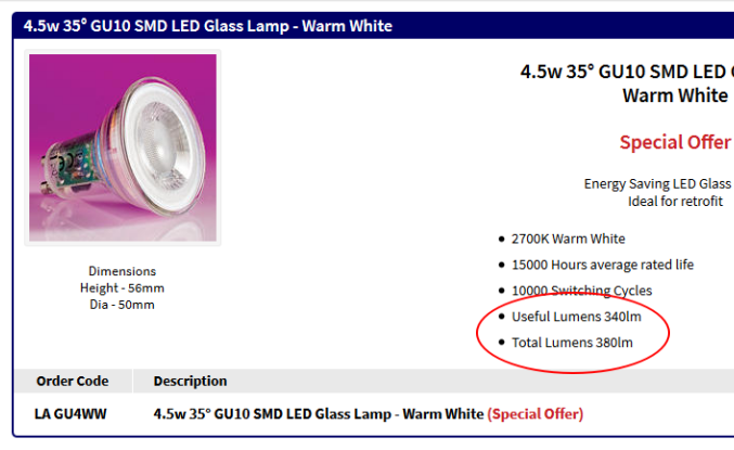

swapping 12v halogen spotlights for 240v LED GU10s
If they are physically the same size, yes. Switch off the power & wire in the 240v to the lighting circuit.
Why not go to LED's
Im not a sparkie.
I swapped the 12v ones in my bathroom (4) for 12v LED's that I bought from B&Q. Working fine.
Why go to 240v ones? You'll have to change the bulb fittings as well as rewire them surely ? My 12v LED bulbs were a direct replacement that fitted in the existing fitting.
I'm next going to change the 240v ones in my kitchen (I have 8 of them) to 240v LED's. Can't use the ones that you link to as they are equivalent to 70w and mine are only 35w at the moment which is bright enough.
Not really...
