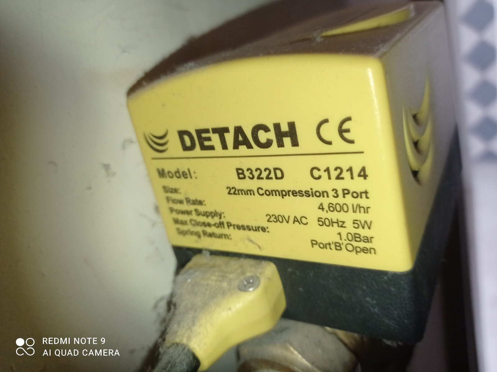

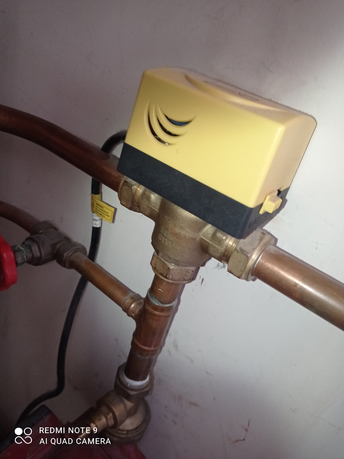

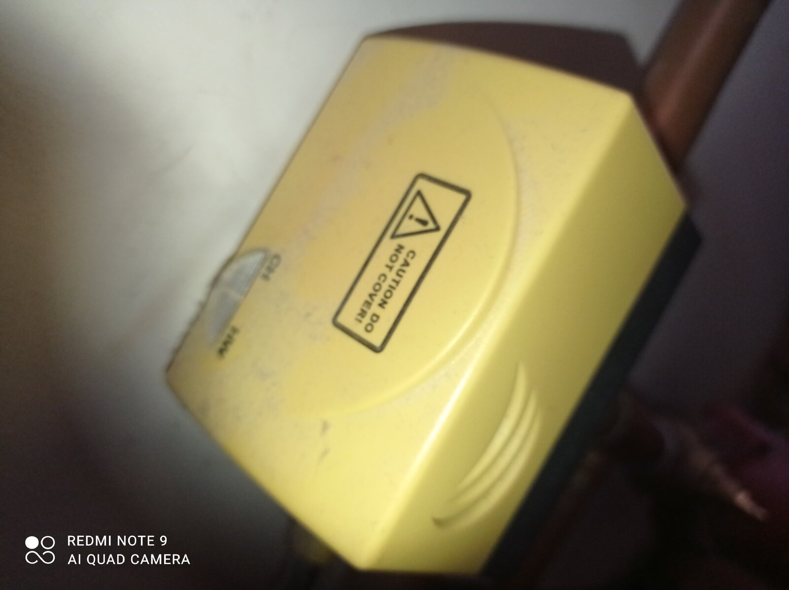

This is the valve any ideas if they still make this model.
How do I know if the new EPH one will have the same actuator? Would I need to email the manufactures?
Yep as already said it is an old EPH just get the same actuator, no need to drain anything , and no need for any rewiring
Actuators almost always have to match the water valve - if you swap actuator, then you will almost certainly have to drain the system down and swap out the valve too.
