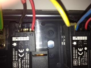

I'm trying to change a double dimmer switch for a double rocker switch and I need a little help in the wiring. I have included 2 photos of the old switch and the new switch. I'm confused with how the switches are labeled the old dimmer has live going into L1 and neutral going into C or COM.
the new switch are labeled L in L out N in and N out. Could anyone tell me how to wire up the new switch please.

Your photographs are too small to be seen clearly even after magnification. ... You don't have a Neutral you have a live and switch live. ... Your new switch looks like it is an intermediate switch. ... You can use an intermediate switch as a normal one way switch by following this link in wiki - bottom of the page:

I know the photograph of the old switch is small but the right hand dimmer switch only shows two cables in the C (or L1) blue/yellow and red in L1 (or C).
So either C (blue/yellow) is acting as the live loop in/out or it is acting switch live out to two lamps - I don't believe it is acting as a two way.

I must admit I haven't come across a dual pole double gang rocker switch before and therefore focused on what I thought I saw - but given the information the OP has provided I am bemused as to why you consider he is lucky?
As I said - the switch does not know it has L and N marked terminals - nor does it know that the cables are connected to the live and switch live. Its sole job is to create a connection between L and L1 and N and N1.
The OP's pictures show he only has live and switch live for each switch - applying the intermediate wiring diagram to the dp dual gang switch would give exactly the same result - you could even wire the N in and N out as the live and switch live with the same result.
So given we have a live and switch live (not a two way) - what other situation are you talking about?
