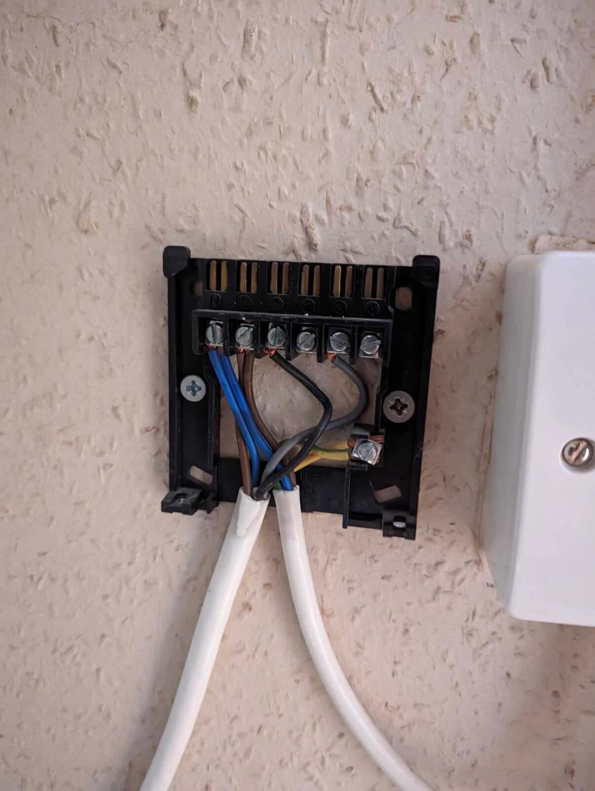

Our Valiant timer on boiler has packed in an additionally the Drayton thermostat and reciever has stopped working (I have replaced the batteries and tried moving closer, it had been in the same place for years anyway).
We have been thinking of switching to a Nest anyway, would this transition be simple? Presumably do away with the digital Drayton thermostat downstairs and fit the Nest where the existing receiver is? Would this solve our broken timer and receiver issues to? Seems pointless replacing the timer on the boiler if this is what we wanted anyway...
I have attached a photo of the current wiring behind the reciever.
Many thanks and please excuse any ignorance on my part!

Provided that the failed boiler timer can be left in a permanently 'on' setting then Nest can provide time and temperature control in a single unit. You don't mention any hot water control, so I take it that you have a combi boiler.

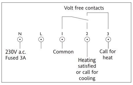

The Drayton SCR receiver wiring is as below:

With Nest 3rd Gen it's just a matter of moving the wires from the Drayton receiver to the Nest Heat link terminals that have exactly the same function. So:
Wires in Drayton N = Heat link N
Wires in Drayton L = Heat link L
Wire in Drayton 1 'Common' = Heat link 2 'Common'
Wire in Digistat 3 'Call for Heat' = Heat link 3 'Call for Heat'.
The Nest thermostat requires a 12v DC power supply, and terminals T1 & T2 of the Nest Heat link provide this. There are corresponding terminals marked T1 and T2 in the thermostat. If this cable doesn't exist it will need to be installed, or alternatively Nest sell a plug in power supply to power the thermostat as an option if you don't want to run a new cable.

You are correct, it is a combi boiler (hot water is working but heating currently off due to faulty reciever). Then timer on the boiler can indeed be set to on opposed to timer.
Thanks for your help, that's great.
