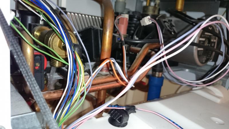

Hi all,
Boiler is a Glow worm Ultracom 30cxi
Our shower is starting to run hot and cold , We had this before ( about 4 years ago) and it was the DHW heat exchanger, this was replaced and all was good.
So the plumber has said he can replace the heat exchanger for £250.
As I can buy a replacement HE for £50 it seems a lot for the labour ( reading about it , it seems to be about an hours work)
From what I can see its a matter of isolating the boiler water supply and mains, draining the boiler and then swapping the unit out.
Is this correct? and if it is what is the best way to drain the boiler ?(There seems to be a view of not to use the PRV for draining.
Many thanks in advance

My boiler is a glow worm Ultracom 30 cxi this is what it looks like inside if that helps
full
Well there you are if that’s a room sealed job you’ve just left yourself open to
prosecution and a big fine or even prison god almighty. Bob
Just ignore the doom and gloom brigade, you have not interrupted the combustion cover and nothing to stop you changing it yourself if you want, you should just clean it though and it will work, brick acid or one shot from screwfix will clean it, but be carefull when using , it is nasty stuff, follow all the safety guidelines

What I was really hoping for is confirmation that you just need to isolate the mains water supply to the boiler (ie do you just isolate at the feed to the boiler or do you need to turn off the mains water supply?) turn off the mains power and then just drain the boiler before you swap it out?
Thanks in advance
you need to turn off the mains inlet below the boiler and open the lowest hot tap, drain the boiler, cover all the electrics, isolate the electrics then good to go, even doing all this , you will still get some water coming out , that is normal, one of the easier plates to change
The main things to worry about are water spraying over the electrics because you've failed to isolate or drain correctly, and losing vital screws down the back of the kitchen units, under the floor etc. Strategically-placed towels, even cling-film, can help.
What sort of blockage do you think there might be? If I were you I'd try just flushing with mains-pressure water from a hose pipe first. If you're in a hard-water area and think it could be limescale in the "output" side, acid could help. If it's due to rust or similar from the CH circulation water blocking the "input" side, I would say that acid is not the right chemical. But I'm not an expert by any means...

We do have very hard water so limescale could well be one of the problems. we did have a powerflush done when we swapped out he old one- huge amounts of sludge. I am also getting lots of particles collected by the magnet thing.
I guess that trying to clean/flush it cant do any harm.
Is it advisable to fit new washers when refitting if so are they a standard size- it would be better to get them prior to removal?
