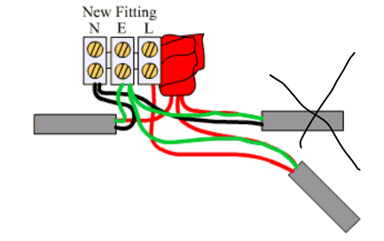

I've looked through the wiki (e.g. here and here) but I'm not sure any of the diagrams match this setup. What am I missing?
That's the one from the first Wiki link I included and I thought it could work but I've only got two main cables. I'm not sure how to match up the diagrams on that page with my setup...
I know; that's why I said this here. :)
IF
this is the only light fitting operated by the two switches just ignore one of the top two cables in the diagram.
One of the cables which connects to neutral.
IF there is more than one light fitting operated by the two switches then you had better wait until we can see your picture.

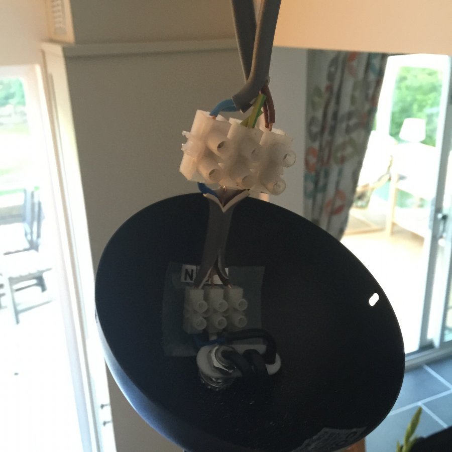

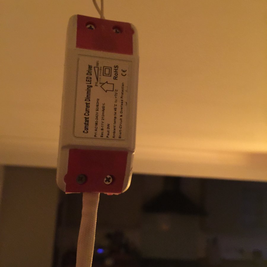

Some pics I took before I removed the old light:

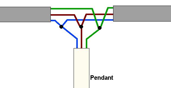

That's effectively it, assuming the joins are just there for illustration? The new pendant obviously has a standard chocblock but it would be very hard to fit the two sets of cables directly into it. I thought about wiring it as below but wasn't comfortable restoring power with it like this:
First thing is to try replacing it with a larger piece - it may very well only be attached by being screwed onto the metal tab which earths the body, and can easily be unscrewed and swapped.
But it must be really tiny if you can't get two conductors into each terminal - so much so that the phrase "not fit for purpose" comes to mind. Is the problem simply that the existing conductors are bent and twisted? What size are the cables?
I thought about wiring it as below but wasn't comfortable restoring power with it like this:View attachment 101987
As long as your piece of choc-block ends up inside the cup of the light that's fine, but you'd probably find it a lot easier to get it all tucked away if you use flex, or even 3 cores from some flex, instead of that short piece of twin & earth.

It does come off as you describe. In my (admittedly fairly limited experience) it is a pretty standard size for a pendant as usually they only have to deal with a single set of 3 wires coming in. Is it as straightforward as just connecting each pair of incoming cables into the relevant terminal block on the pendant?
Is it essential to have the chocblock inside the cup of the light only there's not really any room in there (or won't be when I shorten the cable length). I have got a lot more t&e cable but I assume I'd be better off running it into a choc box rather than trying to tape up the new wiring?
