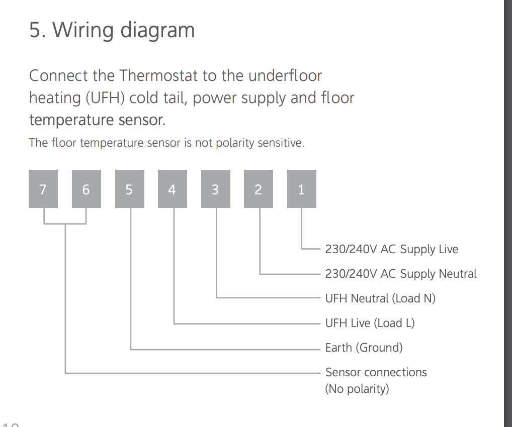

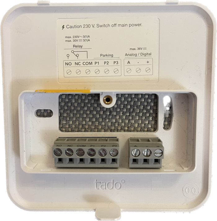

Hi folks, I want to replace my Thermo Sphere UFH thermostat with a Tado unit so it can be controlled using Alexa.
This is the original unit:
And this is the Tado one:
This is the wiring for Thermo Sphere.
Tado:
Is a replacement possible?
Thanks in advanced and happy new year!
