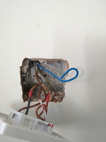

I want to change my outdoor light. Removing the old switched (indoor) light I discovered two core and earth cables coming out of the wall with one brown and blue capped and not connected.
But on inspection the live is on one cable and return (neutral) on the second cable!

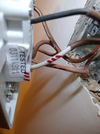

Going back to the indoor switch, which separately turns on the outdoor light and the internal overhead lights, its top row is a used L1 (live Black wire) unused L3, used L2 (Brown); the bottom tier are (left to right) L3 Grey (Brown sleeve, not live), L2 Brown (Live) bridged to L1.
I do not understand this wiring and wish, if possible to remove one of the two cables going outdoors.

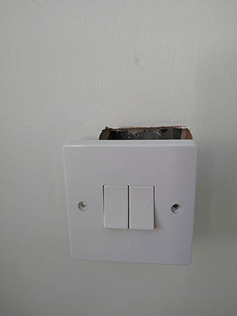

I assume from the switch wiring that there is also another switch which operates the interior light.
Pictures of both switches so that we can see all the terminals and any wires in the back boxes might help but junction boxes somewhere else seems likely.
Thanks. Well that basis, from the left, L1, L3 and L2 are the switch for the indoor utility light; unused L3, L2 and bridged L2+L1 are for the outdoor light. (The Red tape is for my benefit to indicate Live wires.) smallswitch.jpg IMG_20200217_155253423.jpg
Forgot to mention, first switch (left) outside light, second inside.
The crimped wires are both dead under all switch options (checked).
