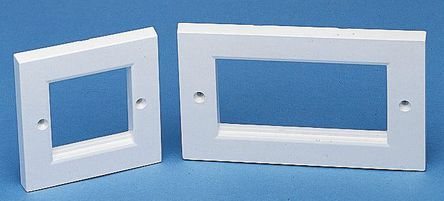

Hi
I'm trying to find a supplier that makes switch plates to order or custom makes, i.e. I want a double plate that houses female sockets for t.v. aerial, phone and computer network all on one plate.
Does any one know where I could get or order these from?
You don't need to have them made - just buy a modular system and stick in the modules that you need, e.g. see p70 of the latest Crabtree catalogue http://www.electrium.co.uk/download_file.asp?Type=C&Company=3&Id=11 .
You can get similar stuff from data-comms suppliers like Black Box, Misco, or general components suppliers like RS:
but I must admit, Crabtree's range is the only one I know of that has telephone LJU and TV co-ax modules as well.
yeah mk keep their grid and datacom ranges seperate which is probablly sensible ;)
as after all you really shouldn't have them in the smame box anyway and this removes the temptation
