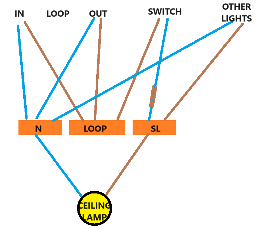

Seems what you might have is a loop in loop out and switchwire in the basic design and the an addition of the fourth wire to go to the fluorescents and thereby connected to L E N, maybe visiting a separate switch on the route or maybe relying on pull or push switches on the fluorescents themselves.

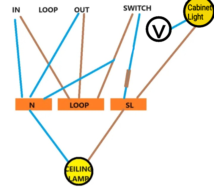

turned on the switch to the flourescents and there was voltage which tells me it is a switched live
If by that you mean there's a switch which controls only the fluorescents then I believe you connect the "floating" black in with the neutrals.
When you supplied 240V to the fluorescents then they had no neutral connection so (what should have been) their neutral wire went up to 240V.

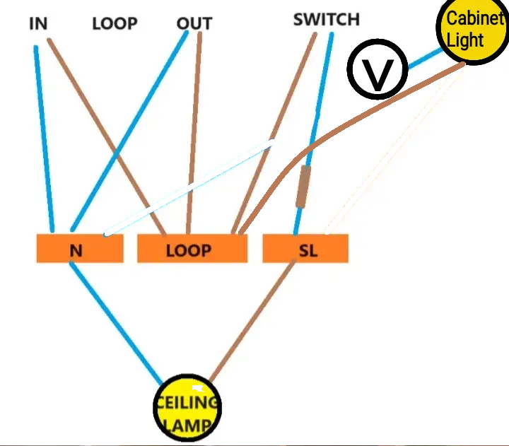

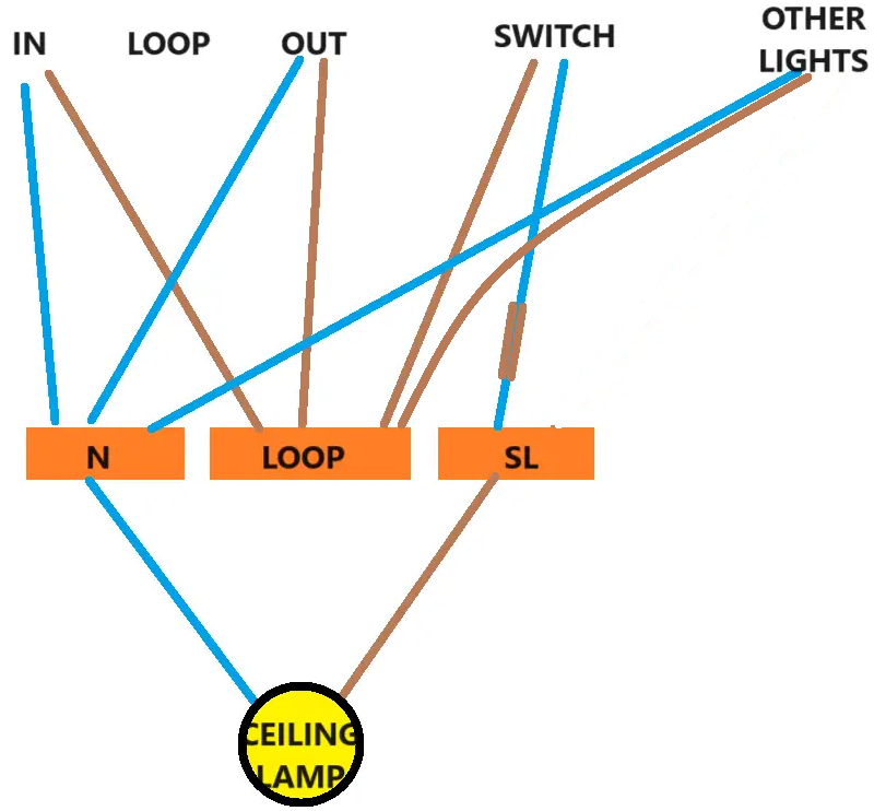

Ah for some reason I read the OP as the wall switch is to control the fluo's too (and assuming each fluo fitting has its own integral switch), which is how I drew the sketch in post#3.
If OP requires permanent supply to the flou and switch[es] then the red does go to 'loop' viz:
I'll use the excuse that OP didn't make clear what is required
