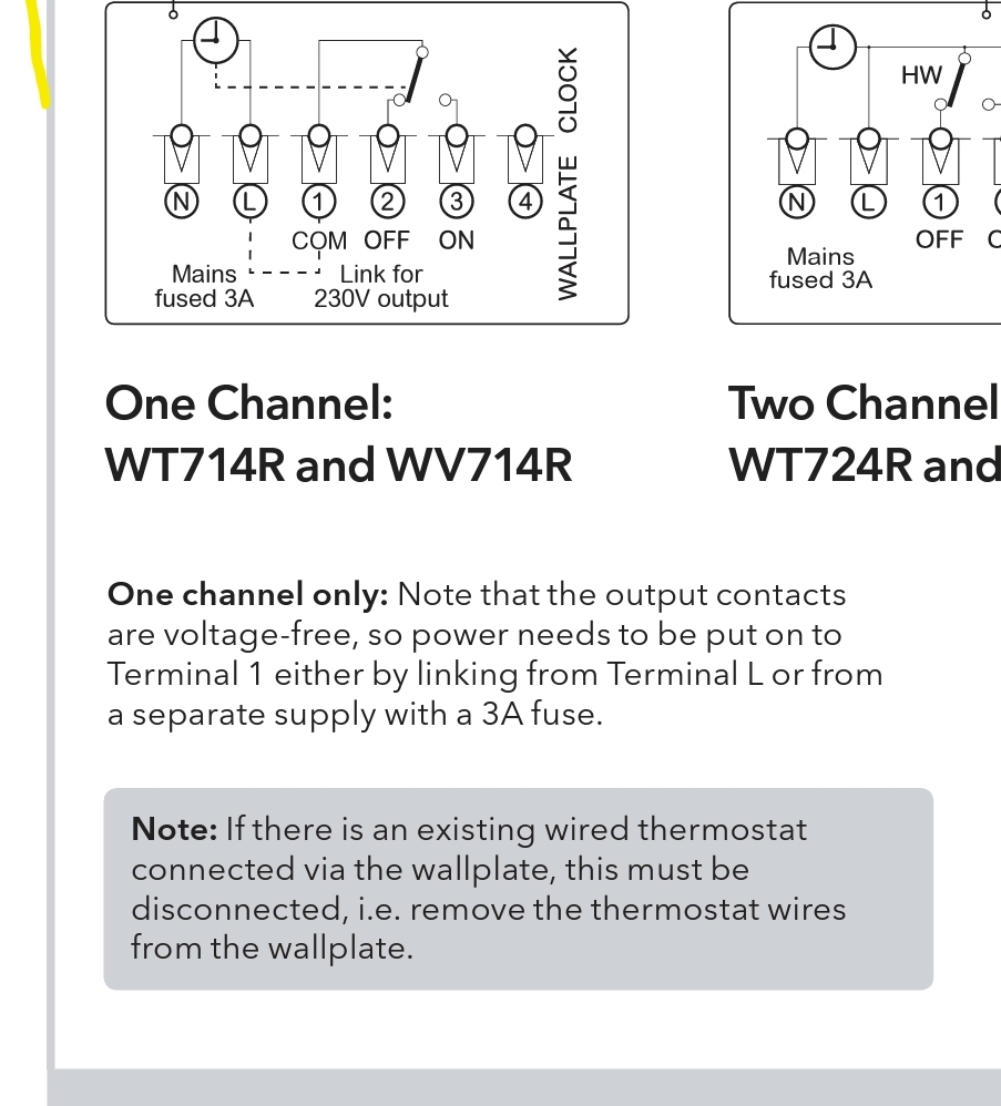

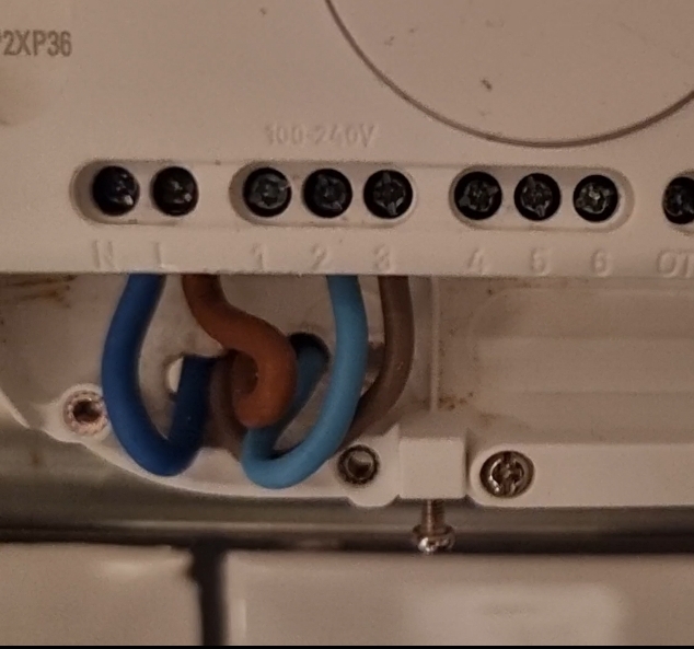

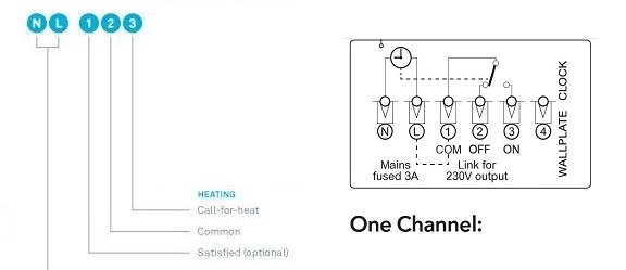

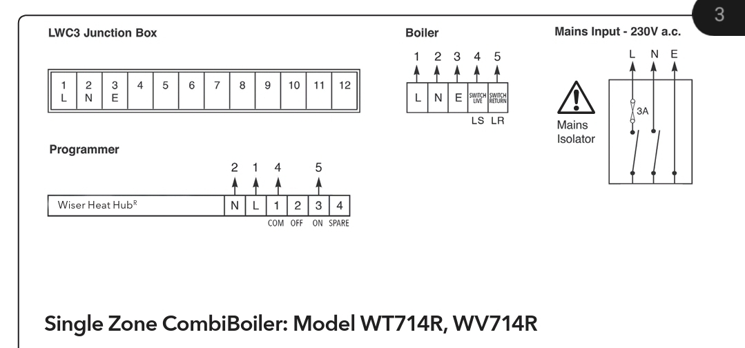

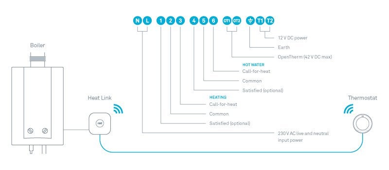

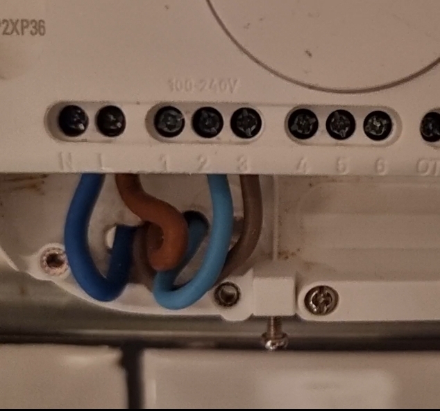

Hi All,

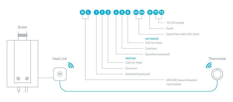

Just need some wiring help. I am switching from a Nest to a Drayton Heat Hub. A Picture of the nest wiring is attached and the wiring guide for the Wiser and nest, which wires should I connect to the Drayton Heat Hub. Sorry this is outside of my wheelhouse.
I have a 3amp fused spur as well for the boiler and just a single zone for the heating.

The 4 wires just move from the Nest Heat link to the Wiser Hub terminals that have exactly the same function:
Nest 'N' = Wiser 'N'
Nest 'L' = Wiser 'L'
Nest 'Common' = Wiser 'Com'
Nest 'Call for Heat' = Wiser 'On'
