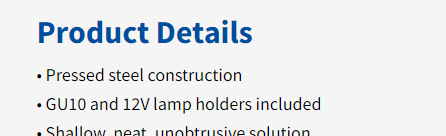

I think I'd be concerned that 12V fittings might not be designed to use 230V.
Unlikely the fittings are designed only for 12v, it would cost too much to make two separate versions of the fitting and lamp holder.
