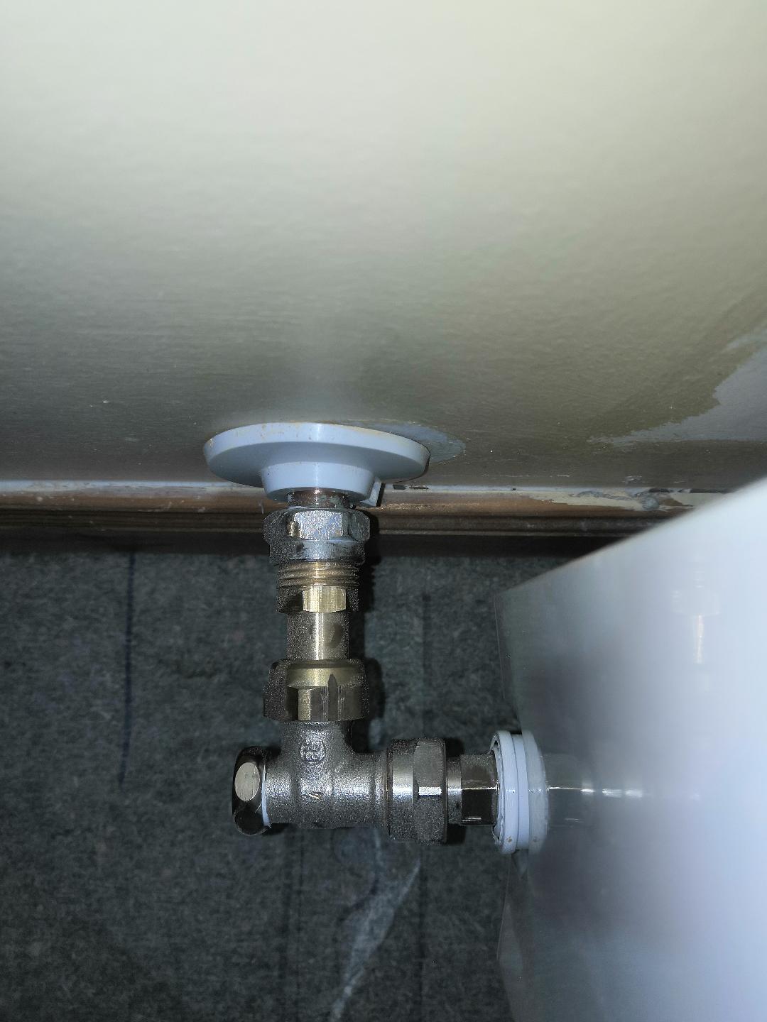

I have a Type 11 Single-Panel Single Convector Radiator 600 x 400mm that I want to switch to Type 22 Double Panel, same size.
I want to change the radiator myself, but can only do it if the location existing valves will line up with new radiator.
I know it will be thicker and I think the same brackets can be turn around to accommodate the different depth? Will this make it closer to the wall and therefore retain the location of connections? There is very little/no give to hand move the existing pipe/valves.

Thanks. That was the one I was looking at actually. Seems like switching the brackets to the more shallow hang will get me back 11mm which counters the 11mm extra depth of type 21 rad but type 22 would still be 11mm out.

I need to bring it closer to wall to line up, not further out!

This appears to be for accommodating width shortfall distance between valve and rad, which does not solve a depth issue?
Yes and maybe! Plus you can try the brackets in both positions now.
Edit to say push the valves out towards the centre of the room!
