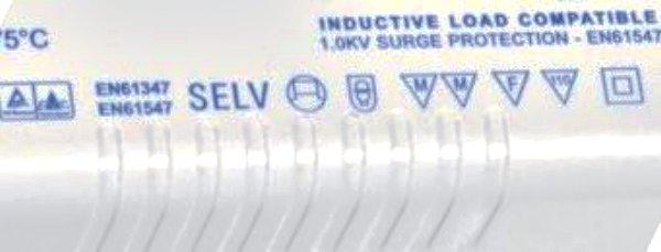

I often find myself looking at the various symbols on electrical/electronic items and wondering what they all mean. A good example is an ELV lighting transformer/PSU, such as:
Apart from the 'double insulation' one, I'm not certain what any of them mean, although I think the one with intersecting circles and a line probably indicates input/output isolation. Try as I may, I've not been able to find where these symbols derive from, so I have not been able to find a 'key' to them. So, can anyone tell me where/how to find such a 'key' and/or explain what the ones in the above piccie actually mean. Ta!

John, correct on the intersecting circles It means that the product control (primary & secondary) can not (under reasonable conditions) connect together (short circuit) the 110 in the triangle is related to the construction requirements for electronic lighting control gear BS EN 61347-2-2

Thanks. Holmslaw has reminded me that many of these are in 559 of the regs - which leads me to ask, in the case of the 'intersecting circles', what on earth is meant by "short-circuit proof (both inherently and non-inherently"?!

The F in a triangle is related to IP rating but I need to read more to understand what "F" actually means in terms of IP rating. The symbol that appears to the right of ELV in your image means "independent lamp control gear" Can't find the "M" at the moment but will keep looking.

According to 559 of regs, the 'F' in an inverted triangle means "Luminaire suitable for direct mounting on normally flammable surfaces".
The symbol that appears to the right of ELV in your image means "independent lamp control gear" Can't find the "M" at the moment but will keep looking. I'm working on a "dumb-phone" at the moment, looking at at a local file on my phone, but will try to post the doc when I get home.

Some more about the F in triangle symbol. Seems it is not IP rating as such.
When a luminaire is provided with the symbol
F
, this denotes that it is suitable for direct
mounting on normally flammable surfaces. Normally flammable surfaces are defined to include
building materials such as wood, and materials based on wood, of more than 2 mm thickness.

For example, what is the M in an inverted triangle (and why is it present twice in the piccie I posted?!)?
Aha!!
single M in inverted triangle = The device is suitable to be installed in or attached to furniture whose behaviour in fire corresponds
to standard flammable building materials within the context of DIN 4102 Part 1. The materials can be
laminated, veneered or varnished.
double M in inverted triangle = The device is suitable for installing on or in furniture which is made from materials with unknown
flammability properties
Aha!!
to standard flammable building materials within the context of DIN 4102 Part 1. The materials can be laminated, veneered or varnished.
Many thanks. It seems to require application of a rather strange type of logic to get to the meaning of by having two instances of the symbol which denotes [a]!
