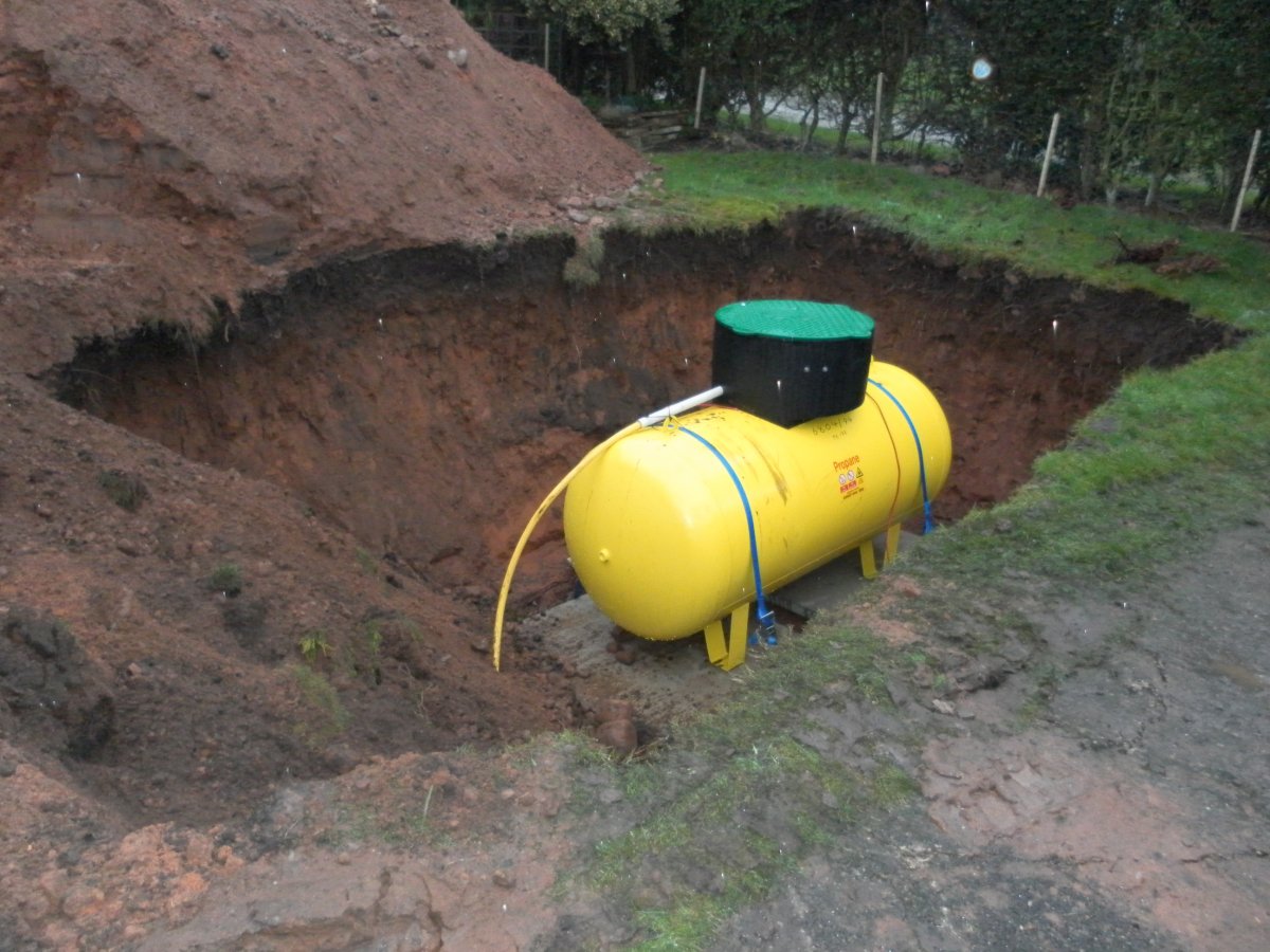

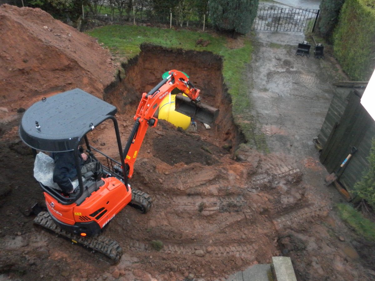

Cost of the oil boiler and tank was a deciding factor I believe. Calor are currently offering an underground tank FOC provided we dig the hole which isn't a problem as her husband has access to a mini digger.

Well it's a done deal now. Tank is in as is the new boiler and getting connected today. SAM_1830.JPG SAM_1833.JPG
