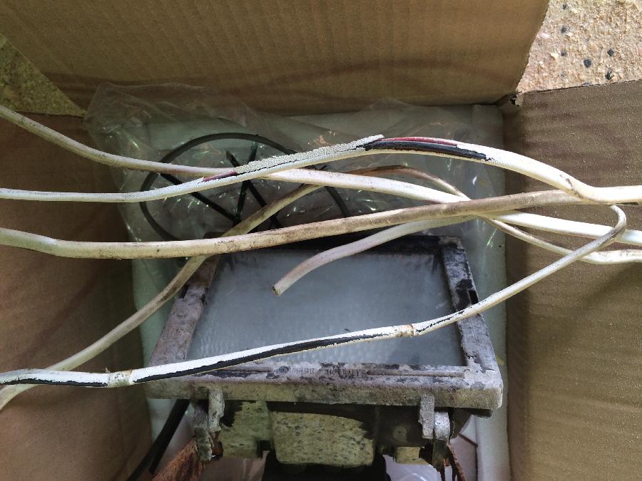

As to first easy we look on the web site and it seems nothing says it is for internal use only. But for the second it is much harder, no one produces a book when doing a rewire giving all the details of cables and other items used. For the MCB we have a serial number, but for the cable nothing. Some times we don't need any info above what our eyes tell us, we can see it has been damaged. But if there is no damage detected then can't see how we can reject it simply because twin and earth has been used outside.
Even SWA can go down, in fact very little damage to the cable can cause water to increase the oxidisation process to an extent where the earth connection through the SWA is lost. So the simple answer is we test the cable and it can pass or fail like any other cable.
