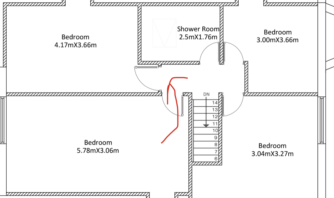

I am currently laying down my T&G chipboard flooring. Just wanted to know how I would go about continue the flooring into the next room…
see plan below… I have to do all rooms. Once I reach door of one room, do I continue the tongue groove into the next room ? Or just start again in next room?
hope I explained it right
If you can continue do so.
Of not make sure there is sufficient gap and take into account of any expansion and contraction otherwise it will squeek when walking in it.

I continued … and now finished. It was quite difficult, I had to continue into 5 rooms in total.
There is a slight 1 lift near one step as there’s steel underneath.
