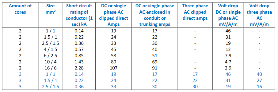

Is this just for Twin and Earth, or would it also include 3 core and earth?
Or would you use table 4D2A for three core and earth (flat cable)
Table 4A2 says 'flat twin and earth' for installation methods
But Table 4D5 only says 'thermoplastic insulated and sheathed flat cable' so that could include 3 core and earth ?
I would include the 3&E in the table for the T&E, but I think you'd struggle to find a situation where it actually mattered
624B Twin & Earth LSZH Cable and 624Y Twin & Earth PVC Cable BS6004 both link to table 4D5 on the Batt Cables website, but since one cable is rated 90°C and the other 70°C this really does not make sense. But for the 624B we also have this
And the three core and two core version shows the same rating. But the installations methods 100, 101, 102, and 103 only seem to be shown on table 4D5 for 70°C cable, I would guess even if 624B Twin & Earth LSZH Cable can go to 90°C the question is can the material it is being run through?
