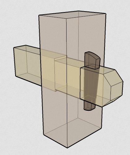

Hi,
I would love to try making a rustic table, it would be my first!
What would be the best method or methods for affixing the legs to the rails?
I am particularly thinking of a method that could be disassembled easily if i were to change house one day.
Thank you
Nat

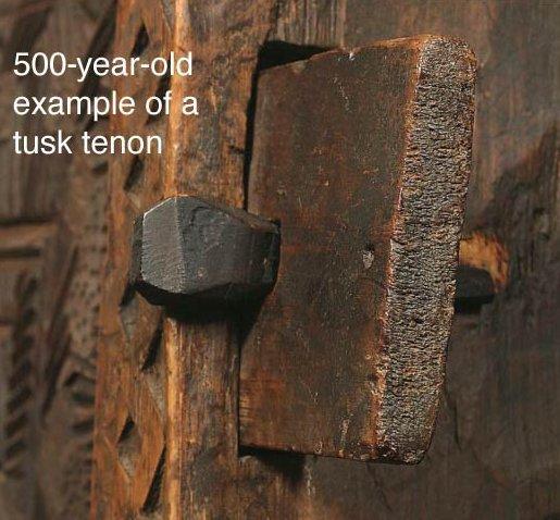

The traditional way to make knock-down furniture which could be dismantled was to us mortises and wedges or tusk tenons:
which is hardly a new idea:
but isn't what I'd call "rustic" either (on account of the fact that it requires both accuracy and a bit of skill to achieve)

I love the tusk tenon, so ,uch character.
