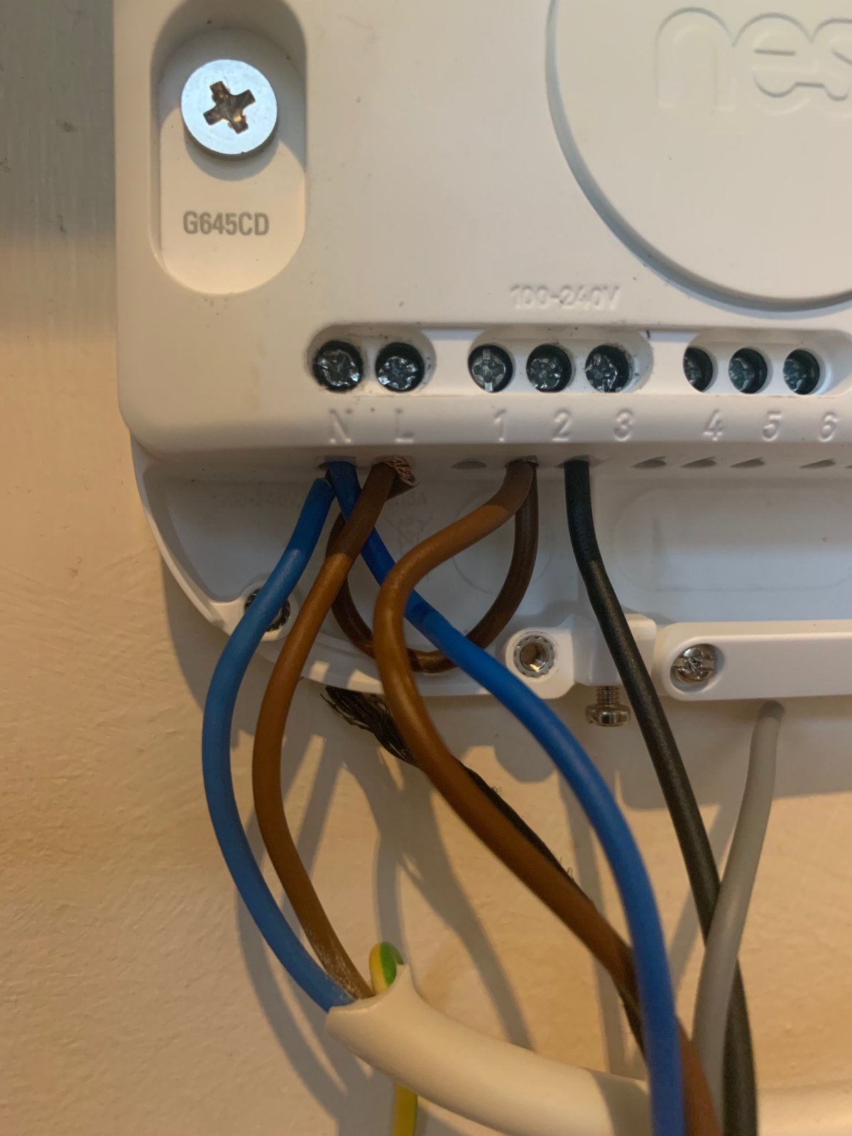

Hoping someone can help. I currently have the Nest heating system connected to my Glow Worm FlexiCom 30CX system. This is work with no issues. I am trying to move from it to the Tado and in turn install the Tado extension.
So I will try to explain the setup as best I can. Hopefully the pictures will help. I will include the setup for the nest if this helps at all.
So current setup from a wall connection I have
Neutral - Blue
Live - Brown
Green Yellow - Earth.
From Boiler I have
Neutral - Blue
Live - Brown
+ A Black Wire
+ A Grey Wire (Never used on the Nest of the previous setup)
So I have,
both Neutral wires going in to N
Live going to L and connection 2
Black going to connection 3
Additionally and this was the same on the previous setup before Nest. I have a Live going from L to 2. Its like a bridge wire.

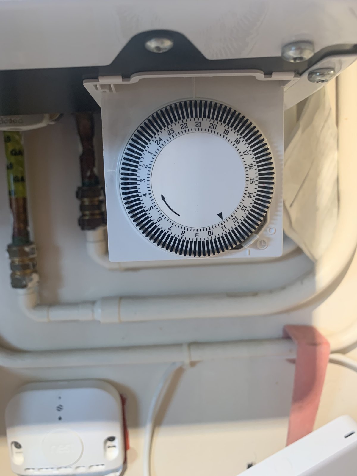

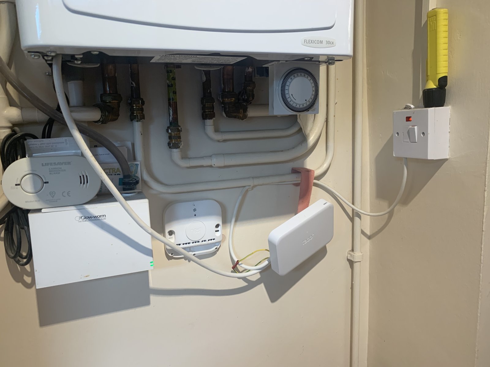

post pics of your wiring both at the receiver and at the boiler, if your boiler has an in built time clock or programmer it has to be set to constantly on
Thanks mate.
I’ve had to more the black wire from 4 to 2 just so the heating kicks in. Obviously I now can’t turn the heating off. Mrs kicking off so have to appease her for a bit.
My boiler timer is set to on. This has always been the case as had to set it like that for Nest.
If your boiler is coming on with the wire that should be in 4 on Tado is connected to 2, then the tado receiver is not receiving a signal from the Tado thermostat to tell it to come on
Thanks mate. My thermostat is wireless and this is ok right? I mean it’s only battery powered not hard wired.
Also my extension is flashing 4 times and pause and then flashing 4 more times. Like that in repeat. From what I can see everything is connected
The Tado extension box by the boiler is flashing. The thermostat is not flashing. According to the manual the extension box should pulse. Just not sure if 4 flashings is classed a pulsing.
Will give Tado a call in the morning. Hopefully they can check that everything is setup right.
Thank you for your assistance today.
