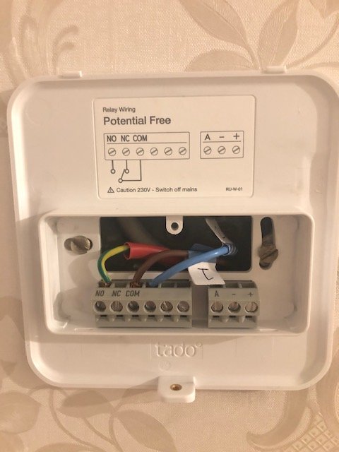

After a bit of advice here, I am a tado user and have had the smart radiator valves and smart thermostat for approx 2 years..
The heating system is an S plan system with HW tank in the loft and a Potterton Netaheat 80E which is old but works ok.
The system was previously controlled by a sunvic timer / programmer. when I installed the smart thermostat it replaced my honeywell room stat, the sunvic timer was set to constant ' ON' for CH and HW was managed by this timer on a schedule.
Slowly I added in tado rad stats for the TRV's and the system was working OK.
Now I have added in a extension kit as I also want to control the hot water with tado ( which works) but also herein lies the issue. It would appear ( with constant back and forth from Tado) that a tado rad stat cannot tell the extension kit AND the smart thermostat to demand for heat.
So essentially what happens is bedroom 1 calls for heat, this goes to the extension kit, and then tries to run it to the boiler ( but the wired smart thermostat is in the circuit) this relay ( in the smart thermostat) does not make the connection and the boiler doesn't fire. I've spoken at length to tado and they said I need to consult with an electrician, in fact their response was the standard cut & paste

My question is, if the extension kit is now calling for the demand from the other devices ( as this has become the primary ' brain' and is switching the heating circuit on and off, is it just a case of the connection that the smart thermostat was making, just needs to be bridged?
More specifically NO & COM ( or rewired at the junction box, but for arguments sake)
This would effectively make the smart thermostat wireless ( as it has it's own internal battery) and send the signal for demand from the Extension kit to the 2 port valve for CH and fire the boiler accordingly.
