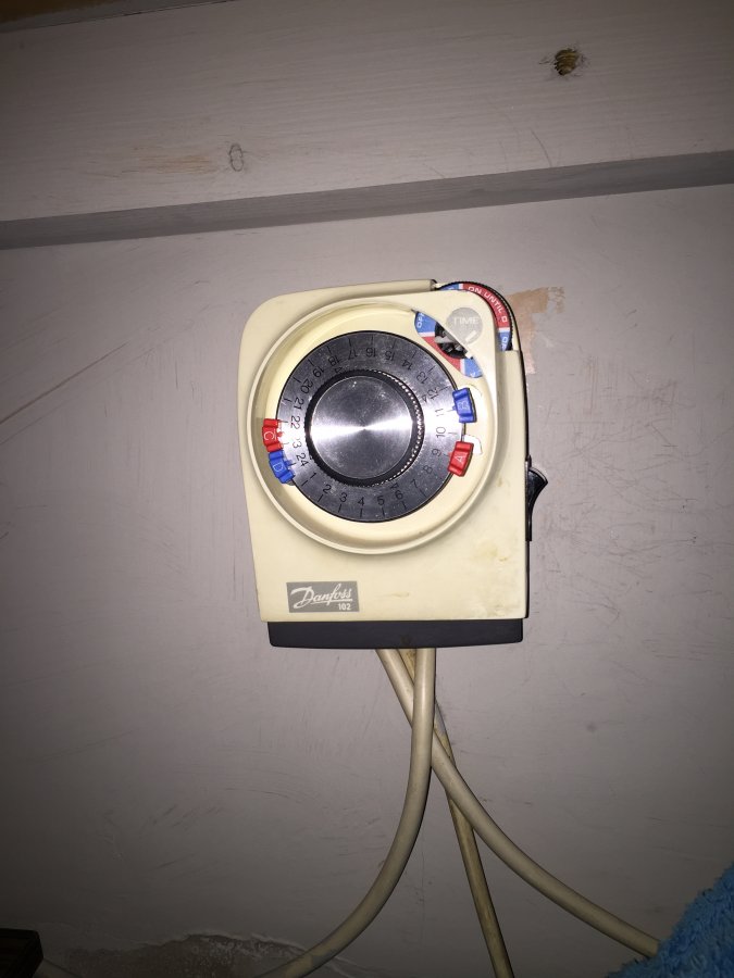

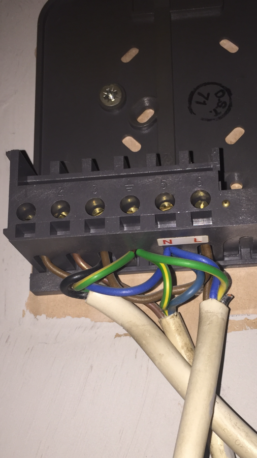

Have an old Danfoss 102 timer unit, I'm swapping it out for the Tado extension kit. Just looking at the wiring... so in 3, what's the black wire for?

If so based on your photograph and assuming the above is correct:
The right cable (with the cut off black wire) will be the mains supply
The central cable goes to the pump
The left cable (with the black wire in terminal 3) goes to the boiler
The black wire in terminal 3 is connected to a permanent live connection, (Because Terminal 3 is also linked to terminal L) and it appears to be in the same cable as the wire to terminal 1 which is the switched supply to the boiler, so I would expect the black wire to be a permanent live to the boiler. This should be easy to check at the boiler wiring terminals. If so, it will need to remain connected to a permanent live as it is now.
If you do have the gravity hot water / pumped central heating arrangement, I would suggest that you check this with Tado before proceeding. Tado may not be suitable for your system as their specification only mentions suitability for Y, S & W Plan Systems which have motorised valves fitted and allow the heating to be run independently of the hot water.
