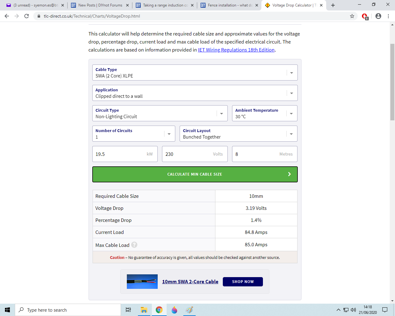

I am taking a range cooker to france and the kitchen fitter in France has asked that I check if the current feed at the house is suitable. To do this I believe I need to check the size of the current cable and the dedicated fuse from the fuse box that feeds it.
The oven specifications list the following:
Electrical Connection 19.5KW
Fuse rating 53 amps
can anyone help me with sizing the cable required for this - eg 4mm - and fuse (60amp??)
Distance to fuse box to cooker is 8m
Darren

Using it the UK requires a 10 mm cable.
From https://www.tlc-direct.co.uk/Technical/Charts/VoltageDrop.html
Does that imply an 85amp fuse?? Manufacturer says 53.
if the unit was running at 19.5 kW it would need an 85 Amp fuse,
The manufacturer say 53 Amp ( 12.0 kW ) suggests that diversity can be applied to the unit when in use.
