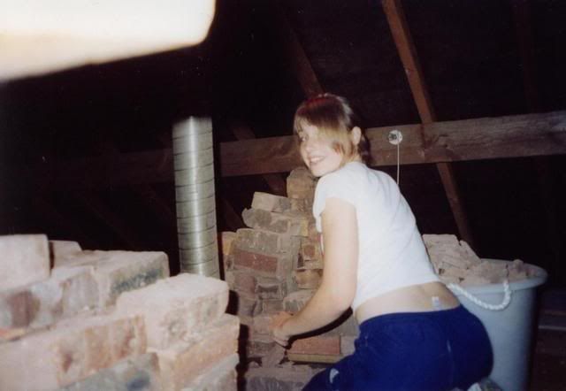

How difficult is it? Any hints tips on doing it?
It's quite easy.
Start at the top and work down!
The only tricky bits are not falling off the roof and making the roof good.
I have removed the chimneys and chimney breasts from all my houses.
[code:1]
[/code:1]
The chimney isn't just there to let the smoke out it helps support the walls.Especially if its an end of terrace.
Start taking out too much and you could lead to problems.
