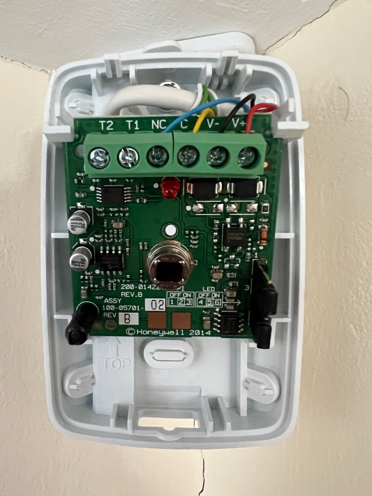

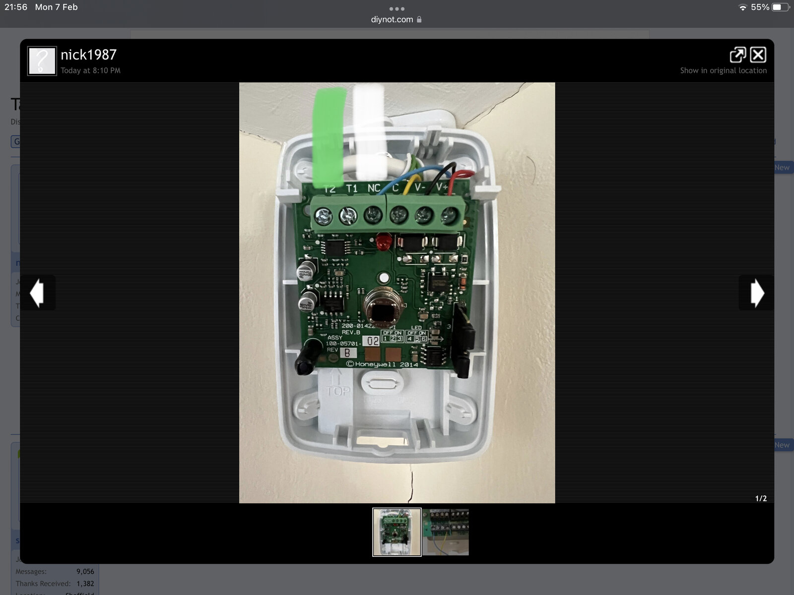

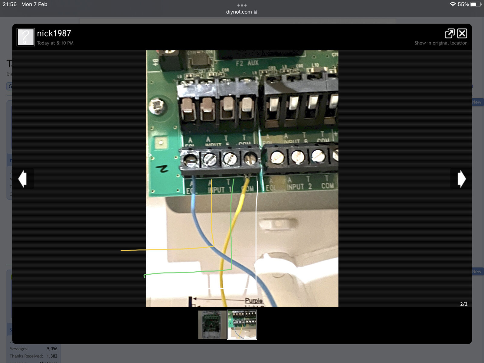

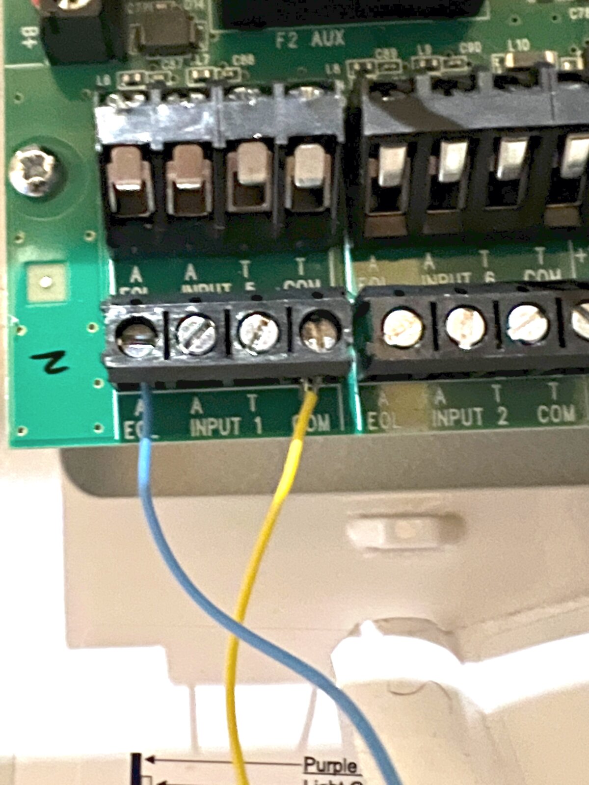

Hi all,
Just need some help I have upgraded my accenta G4 alarm system to a Euro 46 panel, I currently have honeywell IS312B PIR sensors. This is showing as a taper fault for the input. Could someone just check my wiring to see if its correct?
That’s because there is no tamper wired at your pir put the green and white in the two spare terminals at the pir , then wire the panel A A as blue and yellow and T T as green and white
