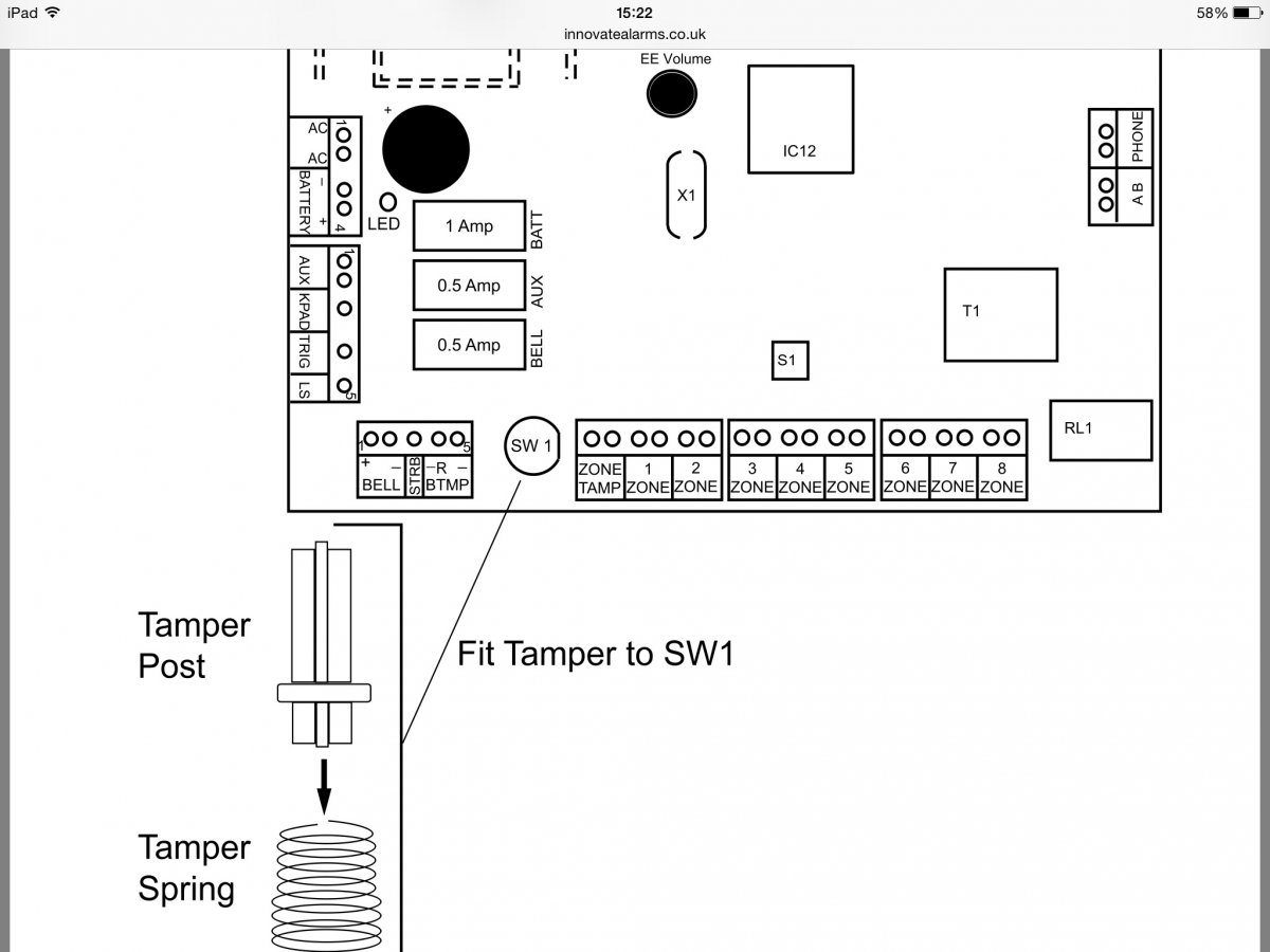

No check lid is on secure it may have jolted off the tamper spring , remove lid and replace ...

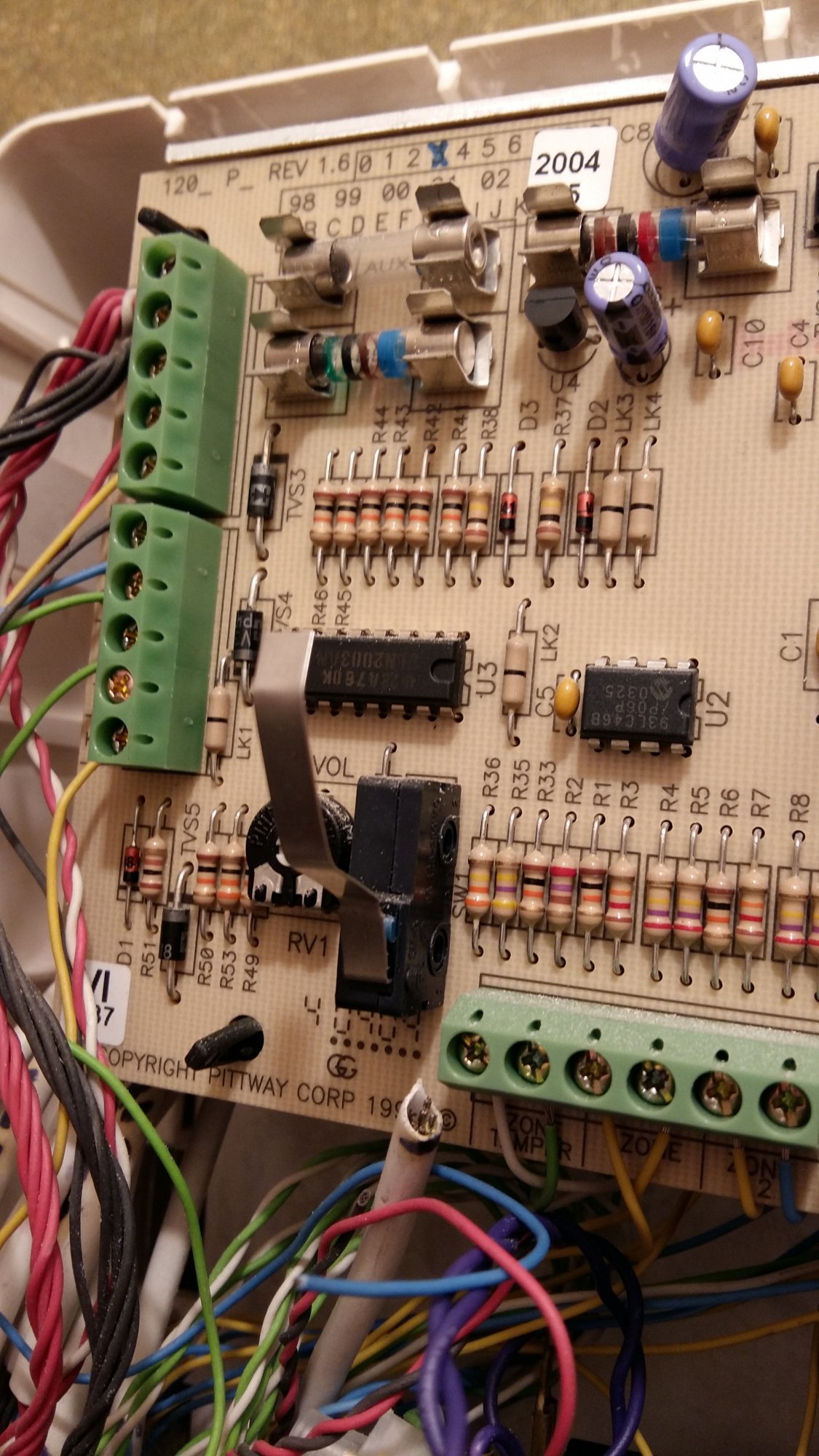

Thanks sparkymarka. The cover is back on but tamper light still on. I've attached a pic to show if the tamper is missing something.
I am assuming the arm hanging out is the tamper. It ties up with your diagram.
Thanks.
It may or not have a back tamper on the control panel, hold the tamper switch and get somone else to reset the panel , see if it clears ( enter code twice )
You my friend are a gent. I had someone do that and it cleared. So the box isnt forcing that arm in far enough to push the switch down. Wonder what changed. I.ve used electrical tape on the inside of the cover with a small rubber to force the tamper arm down so I can get the fault cleared.
