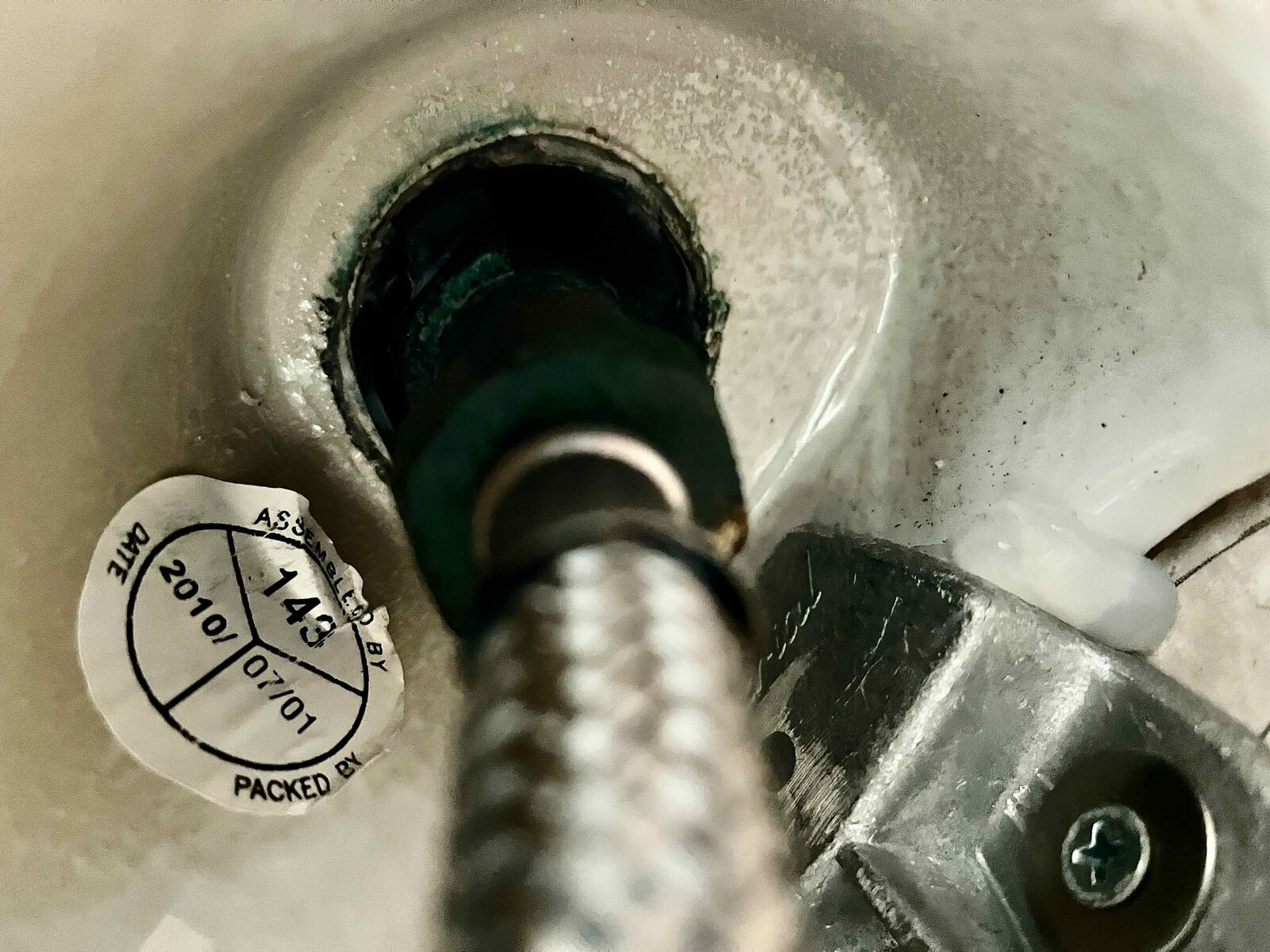

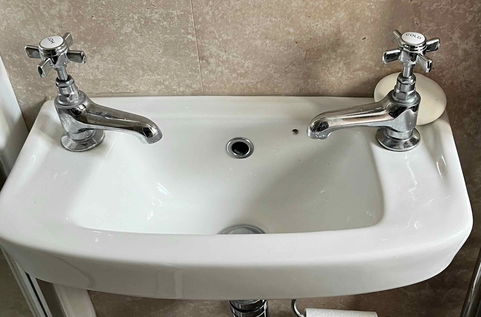

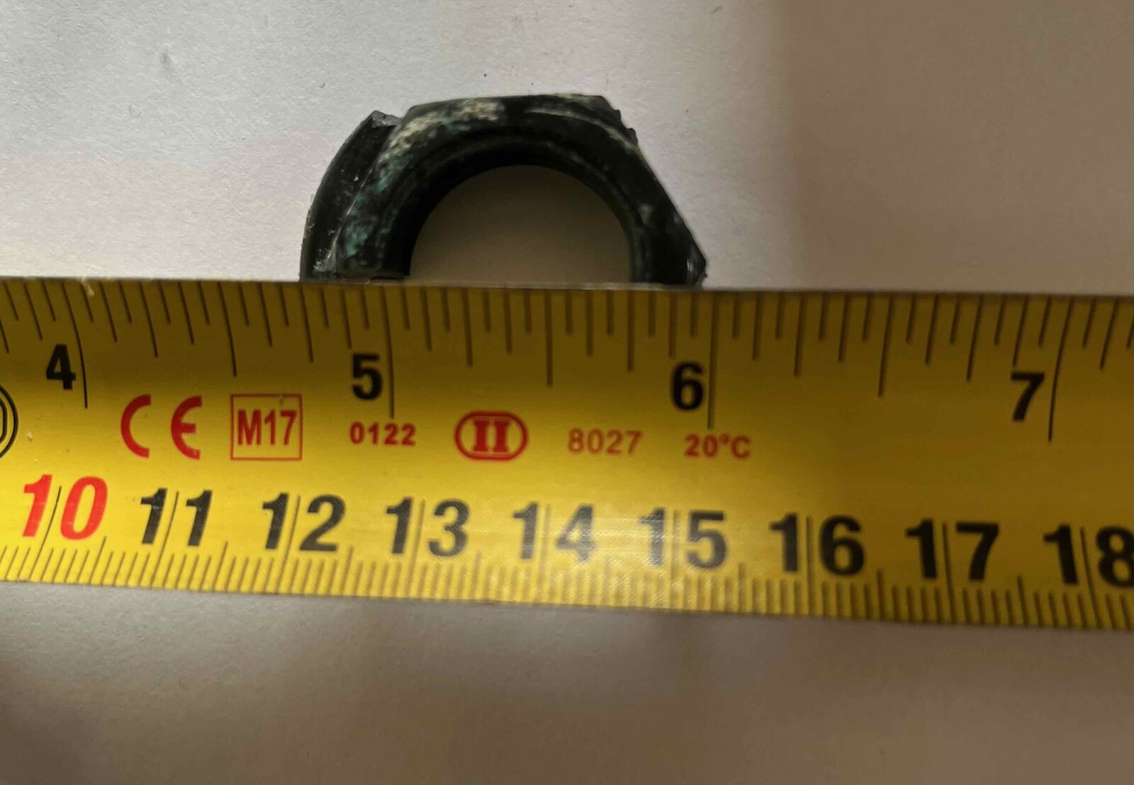

My small Sink, has a loose tap - i looked at the access to the tap, and purchased a Tap Spanner , but when i touched the nut - it fell in half - not sure if this has been cut when the fitters installed
Anyway - I wondered what size this plastic nut is - so i can get a replacement - probably plastic , as i think brass may interfere with the sink itself
Photos attached
My otherhalf is actually talking about changing both the taps any way
But meanwhile here are some images
Do you measure the thread - for 1/2"or 3/4" size - is it BSP same as the flex connector

Wouldn’t bother measuring, the taps will be either 1/2” or 3/4” (usually bath taps). Looking at your photo they look 1/2”, so I’d just either get these or these possibly some top hats, or other anti rotation device. Other suppliers are available.
Thanks for the very fast reply -
I thought they would be1/2" but the thread appeared to be 3/4 - hence the confusion
I was not sure if the brass would fit - and wondered why the plastic appears to be cut - But I would have thought the brass tap backnut should fit and the sink ceramic allow for fitting
Unless I have been supplied bath taps, rather than Sink taps - all kit came from one Bathroom/kitchen company
I pass screwfix/toolstation every week, so I will go along and pickup the brass version - shame they dont seem to carry plastic - or at least i cannot find
Edit
That link was useful as it explained how to measure the thread - and that 3/4" is infact 1/2 BSP
Thanks for that

Could have been overtightened on installation, or become brittle, it is plastic after all. I’d just go with the brass ones.
