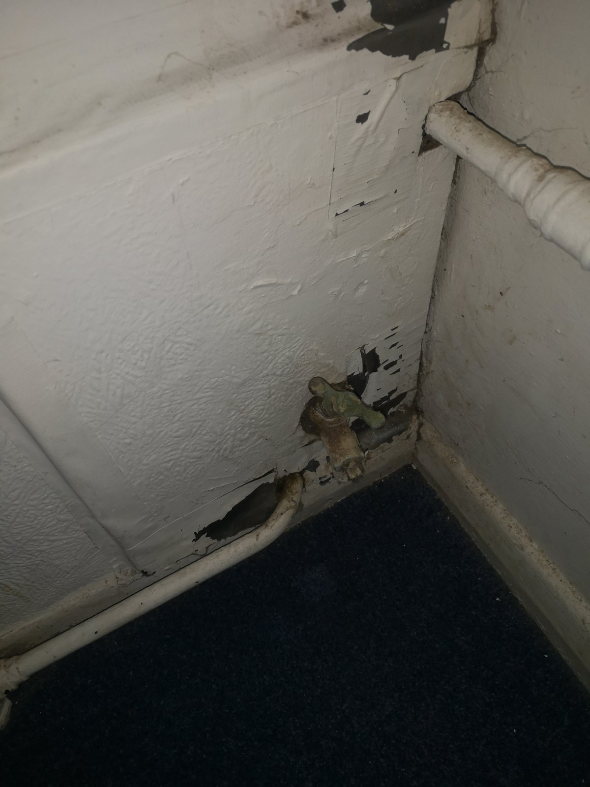

Hi.
I have asked a few questions recently.on my plumbing as I'm trying to shut the water off to my house to fix something
I've looked for the stopcock in the kitchen and a cupboard inside but I can't see it anywhere

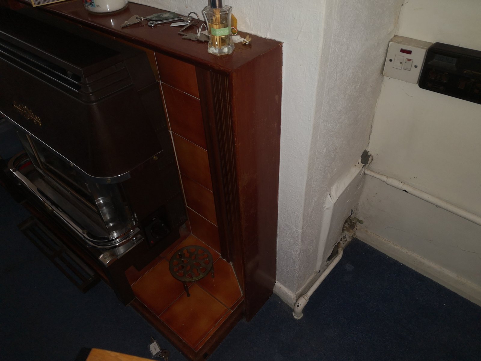

I've always wondered why I have this Tap in my living room near my back boiler/fireplace but not touched it in case.
Can anyone shed some light on this at all? I'm doubt it's what I want it to be

That tap is probably the drain off for a back boiler.

Doubt not and shut that tap then go to the kitchen -the cold water should be off.;)
So you think it's what I'm looking for?. I hadn't touched it in case water does come out on my living room floor lol, based on that day today that would be my luck.

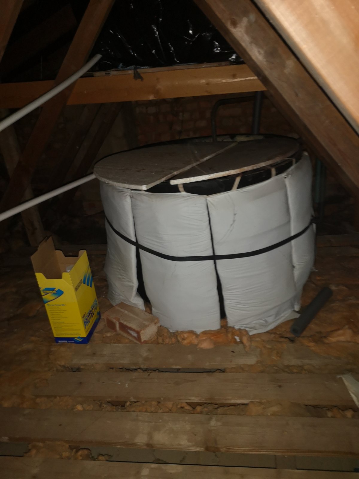

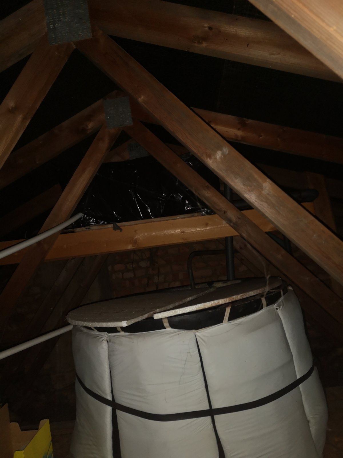

I thought I'd check my loft for the first time today too, and check my water tank, I didn't venture in too far in the end, but I was hoping to see a water tank with good insulation and a well fitting lid, not quite

If you measure the lid of the roof cistern you'll be able to get a plastic one - and a Bylaw 30 kit for the insulation. The giveaway on your tap in the chimney is the "crutch head" - the T shaped top of a stopcock. It's got a combined drain cock. The idea when built was to have a void up the side of the chimney breast for boiler pipes and the rising main. In a way you're lucky the tap head has been left showing - some are completely hidden in the boxing.
That's good news then and thanks for your help, I'd always thought if should be boxed in but in this case I'm glad I can see it then
Out of interest, the large water tank in the picture above, souks you have any idea what they feed? I've read several things from those tanks supplying the bathroom taps, cisterns etc so possibly drinking water etc but I don't know myself Either way I'm. Not living there right now and it's quite a large tank so getting it empty and refreshed when we get in would be handy
