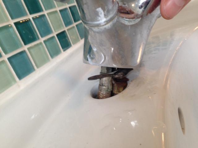

Hello,
Firstly apologies if this is very basic, never done any DIY with taps/plumbing before...
The taps on my bathroom sink have became very loose. Upon inspection the nut under the sink has came off and the washer below the tap and above the sink has broken too.
Can I buy a new washer and nut or bolt to attach it - does this have a name?
Many Thanks,
(Here is a picture >)
All/most monoblock taps come with this kit.
Usually with one bolt but this kit does 1 or 2 bolt taps so will do you.
