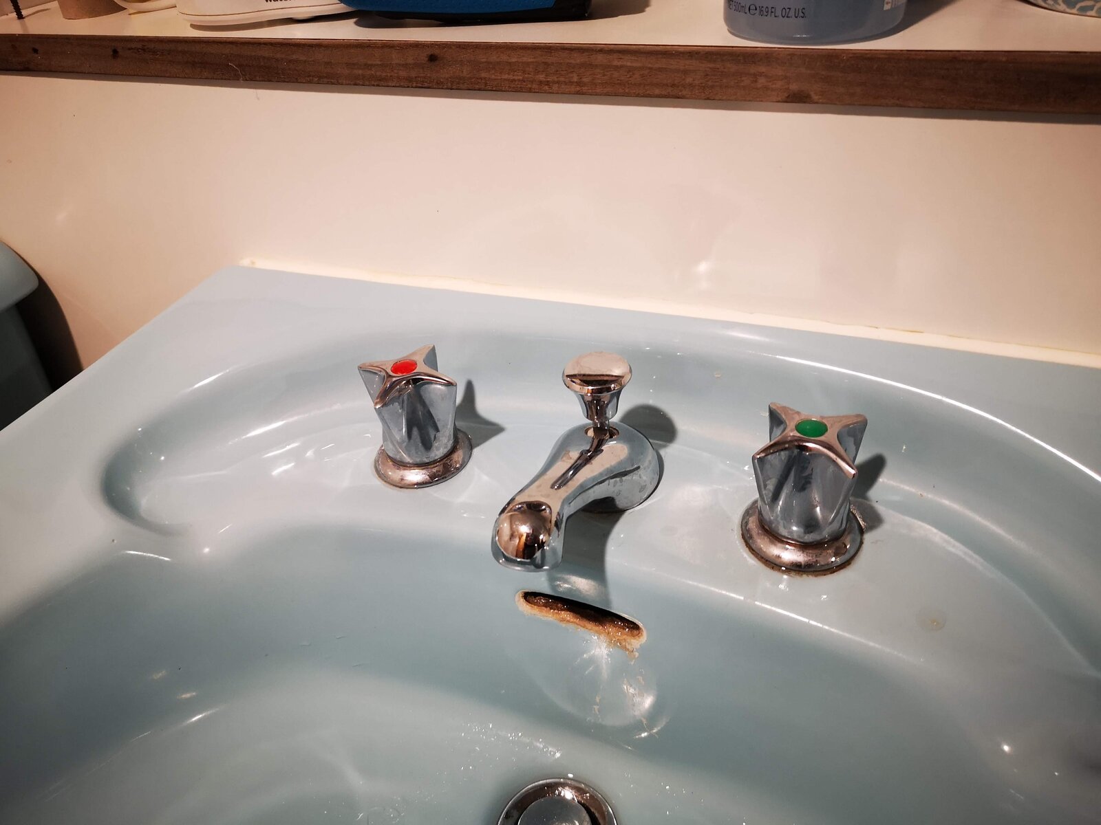

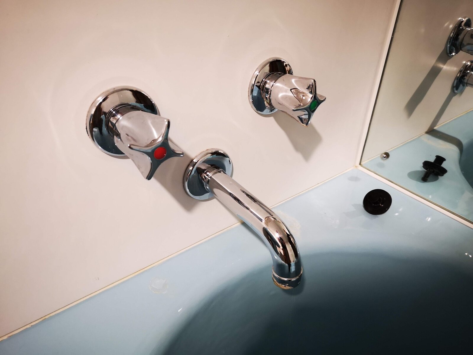

These tap tops are fastened by a screw, but they won't come off.
All the taps need a service, but we need to get the tops off.
Any tips to try? Tap the tap top with a small handle? WD40?
Is it possible to get similar valves if I have to replace them?
Anyone recognize the brand? Probably 1960s or 1970s vintage as the shower is a Mira 8
Regards
DC
Cut a piece of 10mm ply, with a U cut into the end which is wide enough to slip over the narrow part of the head, but not the wider part. Use that as the pry bar, with a bit of timber under it, as the fulcrum.
You can buy tap refurb kits, which replace all of the moving parts with new, with adaptors and new handles - your old handles will probably not fit, so you would need to do them in hot and cold pairs.
