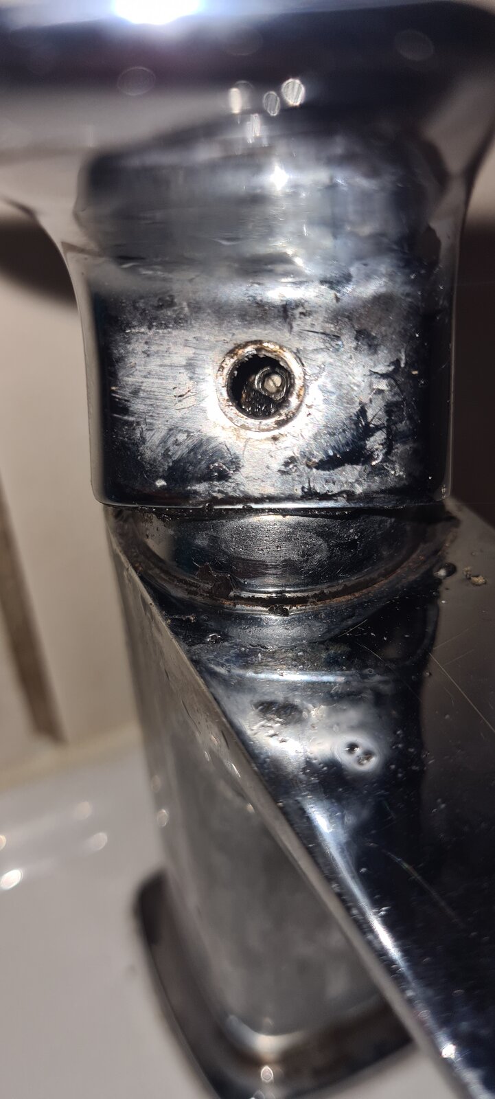

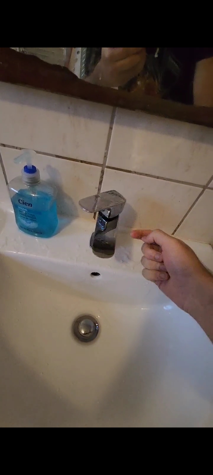

Hi guys got a bathroom tap, bristan make..won't turn off..handle loose both left and right, ie hot n cold..sny ideas..ta.see pic

Small cap to front or rear hides a grub screw which secure handle to splines , it come loose and needs tightening.
Thanks but there doesn't appear to be a screw in there..I've tried some small Allen keys..?
Thsnks tried slotted screwdriver nothing to turn ..maybe it's fallen off and fell inside the tap..so much for bristan quality ...looks like a new tap then.
