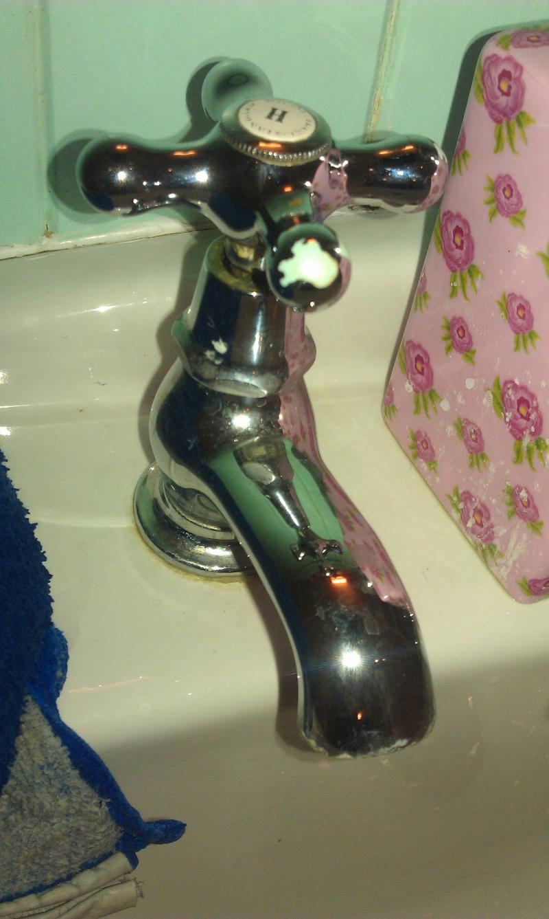

Hi,
We have just moved into a house and they have the following taps in the bathroom:
Both the hot and cold don't work very well. When you turn them on they either dribble or don't work at all.
Is this something that can be fixed or do I need new taps?
Many thanks,
Chris
new taps can be as low as £25 a set at screwfix, much better and easier.your only danger is the wife saying need some new tiles and a bath to go with those new taps or minimum new taps on the basin or bath to match those
If you can turn the water off easily, take the top of the tap off, I bet its come apart inside, thats what happened to mine, they look similar.
Take the white bit off, undo the screw, undo the chrome top (with care, so you dont mark it).
