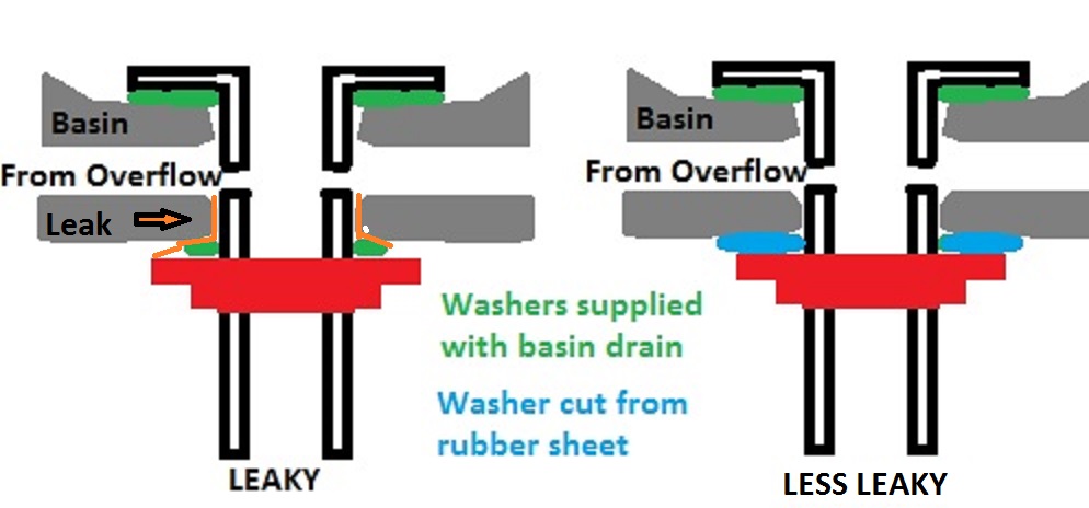

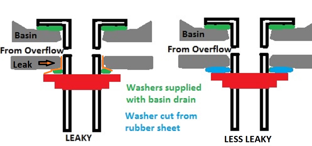

Should not be a need for sealant. That said the washer provided for the underside of the basin is often too small to make a good seal for water coming from the basin overflow.
The basin waste does not leak when there is water in the basin but does leak if water is going into the overflow.
My solution is to cut a larger washer out of medium soft rubber sheet to get a good seal between the underside of the basin and the plastic nut.

The only addition to that waste idea is that the water can also run down the threads, if the supplied seal doesn't seal tight to them, ergo using a basin mate. They're tight enough where they almost screw up onto the basin waste taking up the gap in the threads or alternatively using a little silicone into the gap between the waste shank and the basin waste hole to seal it up.
