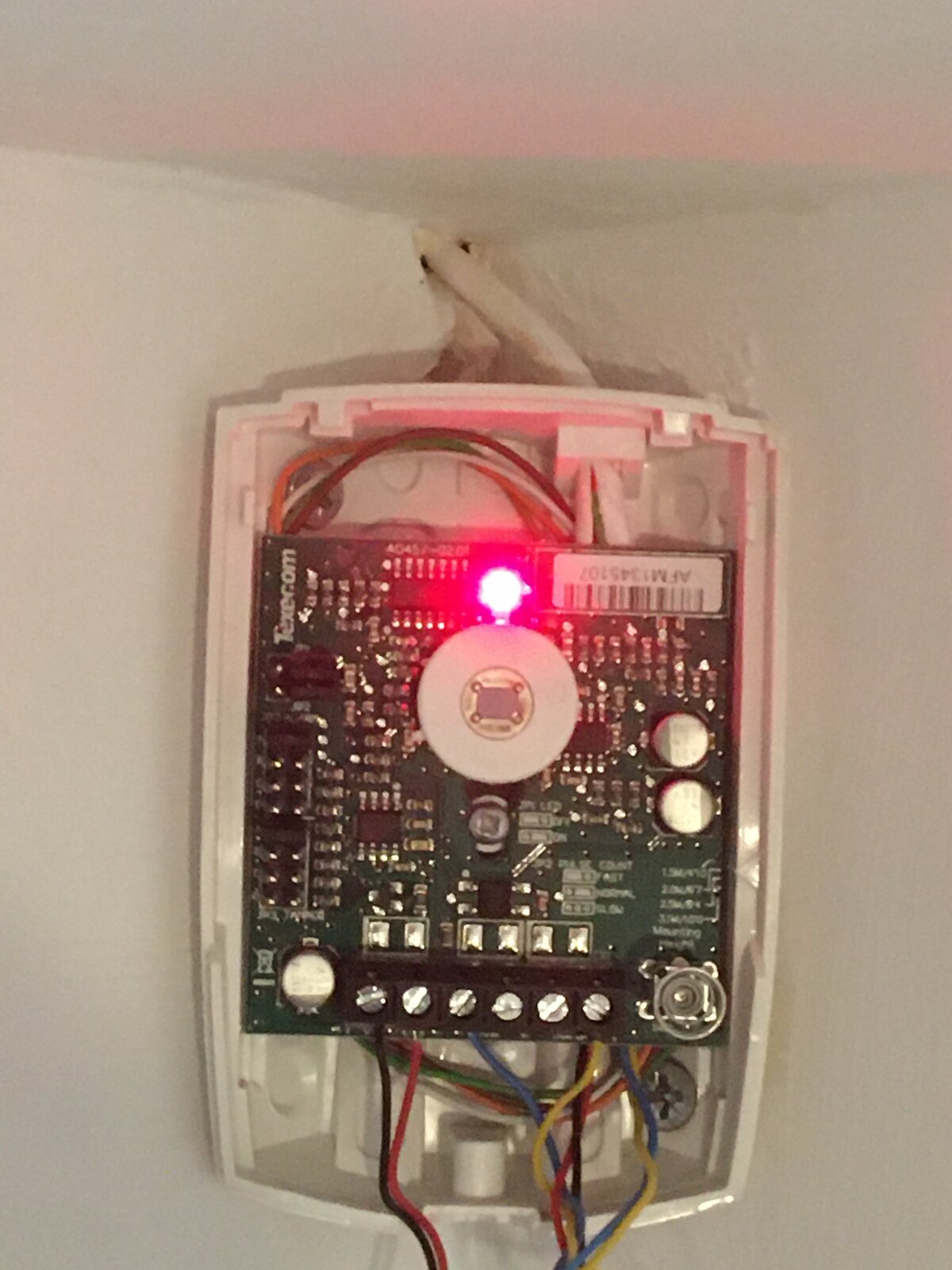

The PIR that is fitted is a texecom unit the first I took the cover off is like this. Looks like EOL wiring but the jumpers on the left are not marked . . . . Have not taken the other three covers off yet, thought I would seek advice from the learned gents on here before I do something that could screw it up.

Now the new sensor has more jumpers - 2 sets of 4 on the left marked "Alarm" and "Tamper" (e.g. alarm marked 4k7, 1k0, 6k8, 5k6 which look very much to me like resistances of which I select one.) Two jumpers on the right are LED on and pulse which I expect to leave as is. And it has seven terminals instead of six! The seventh marked IRLED. I thought the panel instructions would give some guidance but not a lot - 1/2 page in 150 ish.
Now I assume (and that is what I am checking) that the 0/12v are straight swop as are alarm (1 connection) and tamper (1 connection) but how do I work out how to set the jumpers for resistance if I can't tell how the current sensor is set?
Third question: The pet PIR box states "selecting PER mode adjusts the digital signal processing algorithms to increase animal immunity up to 35kgs" is this the "Pulse" Jumper and does it need to be PC1 or PC2 for pet
