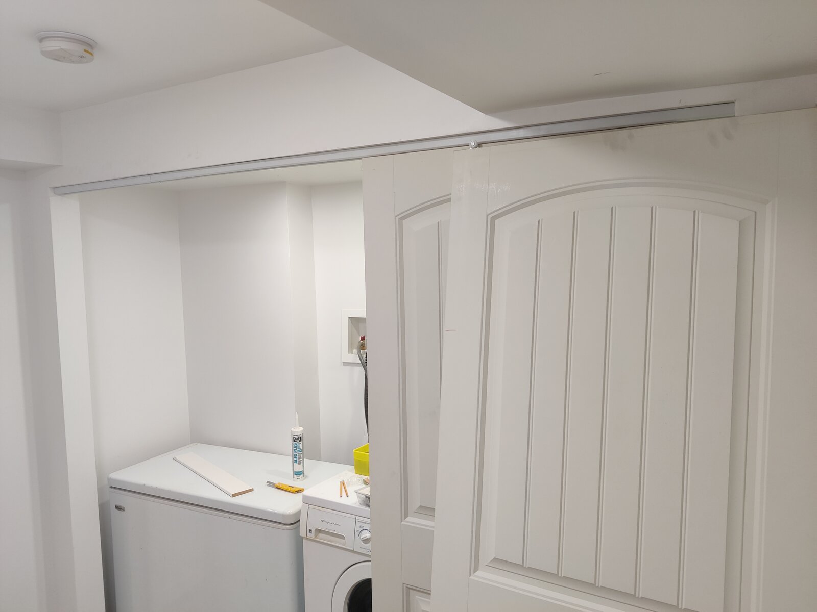

Does anyone have any techniques for joining two cupboard sliding door tracks together? My opening is longer than the max length of one track so I'll have to just line them up, but there will be a bump where the roller moves over from one track to the other.
Tracks are pressed sheet metal, rollers are white plastic.

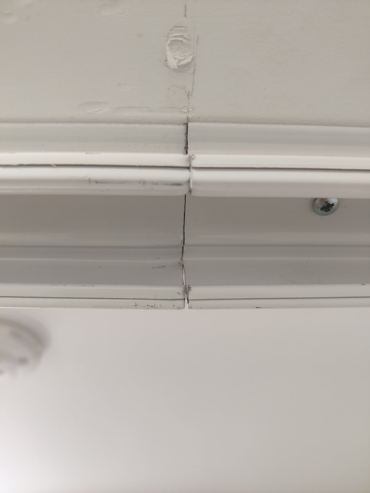

Here are some pics. It's pressed steel I think, longest they sell it here is 72 inches, meaning I had to buy 4 and cut them (3 sliding doors). I tried to put some electrical tape on there and it didn't make too much difference! Thanks for the help

I imagined a more "Patio door profile" and wheels on the bottom.
so yours looks like the wheels run inside the tracks from the top?
Your alignment isn't exactly perfect
If you have an off cut you could take say a 50-100mm section and cut a 5mm slot right through the centre along the line of travel.
Then try to fix each half inside the track, using double sided tape to start.
Dressing each side of the insert with a file or sander to make a chamfer might help.
The other option would be to smooth epoxy over the join, move as much as possible when malleable, then sand

Would it have helped if rather than the tracks being cut at 90 degrees square - had they been cut diagonally at 45 degrees across the width of the track? The transfer from track to track would have been more gradual. Also the two sections will need to have been firmly fixed to the same rigid surface - the bump is caused by the slight misalignment and slight movement of the track, as weight transfers from one section to the next.
