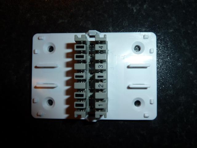

Hi,
I wish to split my phone line into three from the master socket and purchased this Junction Box
Sorry if I am being a dunderhead but the box looks confusing. The packaging says 8 way, but I obviously only need 4 way (one wire fron the master socket and the three spurs).
My question is, can I connect the four sets of each coulered telephone wire into any of the slots??
I am a little confused as to why some of the terminals are numbered and not others!!!!
Any help on how to wire it up would be greatly appreciated, there were no instructions with the box...

It can be done but it is not ideal.........cant the three extensions go back tothe main socket?? but you can put all 4 cables into this as you say make sure the same colours all go into the same numbers and make sure you use a krone tool.
Thanks Johnboy42
I did not want to tap into the BT Box with the other wires, as I did not think you are alowed to interfere with their equipment???
The Junction box has two strips with eight terminals in each, why is four of the eight in each strip numbered and not the others??
I aassume I can use any of the 16 slots for the wires???
You have 8 "ways" one to the left and one to the right of the number.
They are connected together. So you can join 8 cores to 8 cores. Hence 8way on the packaging.
This makes 4 pairs. Hence numbers 1 , 2, 3 , 4.
Any clearer?

Erm not really what you have is a basic straight through conector, think of it as an 8 way electrical screw type block but punch down intead of screw.
In other words what you connect on the left you get on the right.
With punchdown it is recommended that 2 wires per terminal is max (using the correct tool dont be tempted to use a screwdriver as this will just widen the gap and lead to a bad connection, any diy store should stock a cheapy plastic one)
The amount of wires connected could have a serious detrimental effect on your broadband connection.

Yes but it also appears to have provision for disconnect of the pairs. The pins in the centre may require to have connecting links installed.
That is true and the reduction in speed is greates in "star" wiring where the wire branches out in several directions from one point. Star wiring will not affect phones but it will reduce broadband speed.
If you have broadband then consider the use of a NTE5 filtered face plate

to separate phone signals from ADSL ( broadband ) signals. Then you can wire your phones any way you like without affecting your broadband speed.
