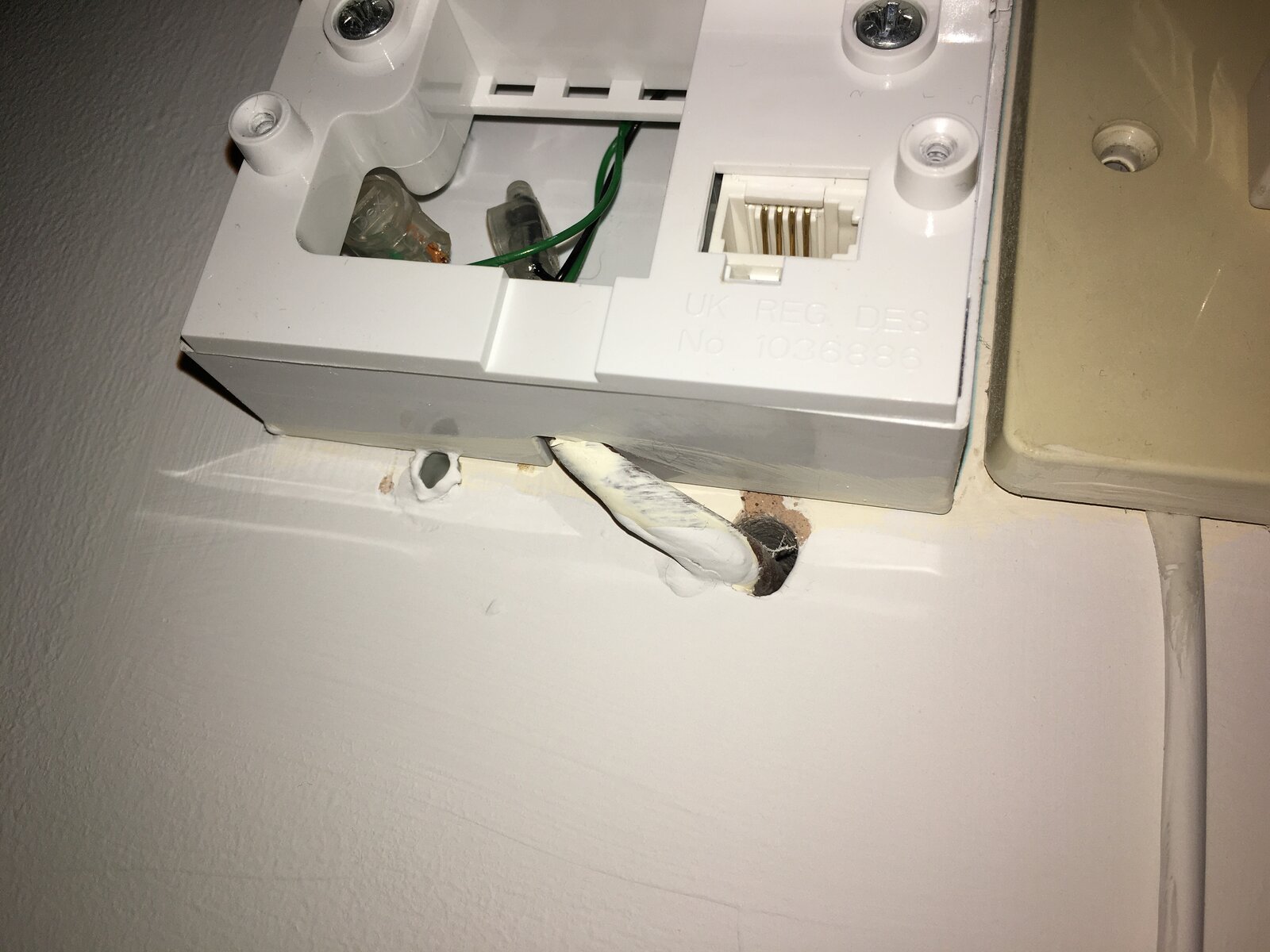

could anyone tell me what these 'telephony' sockets are please? and more importantly if i can test they are doing anything/live ?
1st image is master socket
2nd image shows the socket cover to the right of that - i dont believe that the wires in side (4th Image)are connected from the 1st socket but one of them does loop out to the 3rd image socket - just trying to figure out if i can remove them - the sockets

You can test them with a multimeter set to measure DC volts across pins 2 and 5, or, just plug a phone in!
I can't enlarge your bottom three pictures, the one in the middle looks a lot more like a network socket, push up the little dust cover flap and look inside to see if it's an RJ45 socket or a BT phone socket.

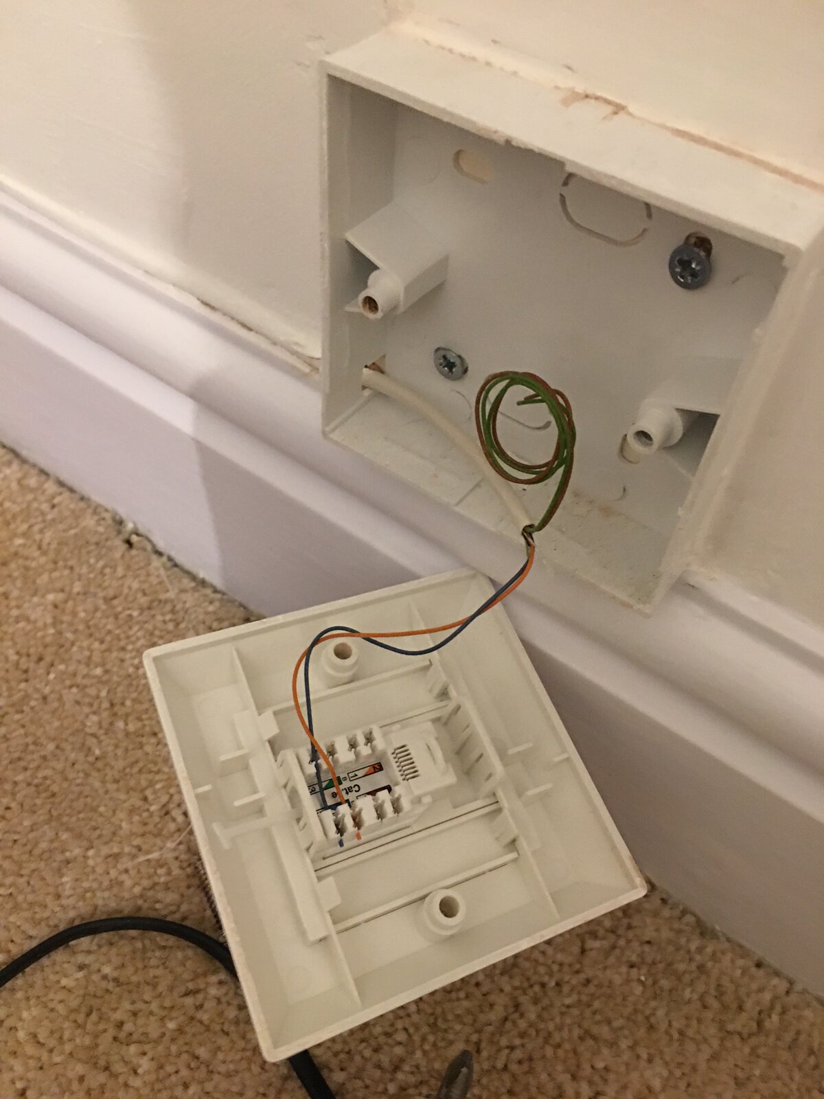

pic two

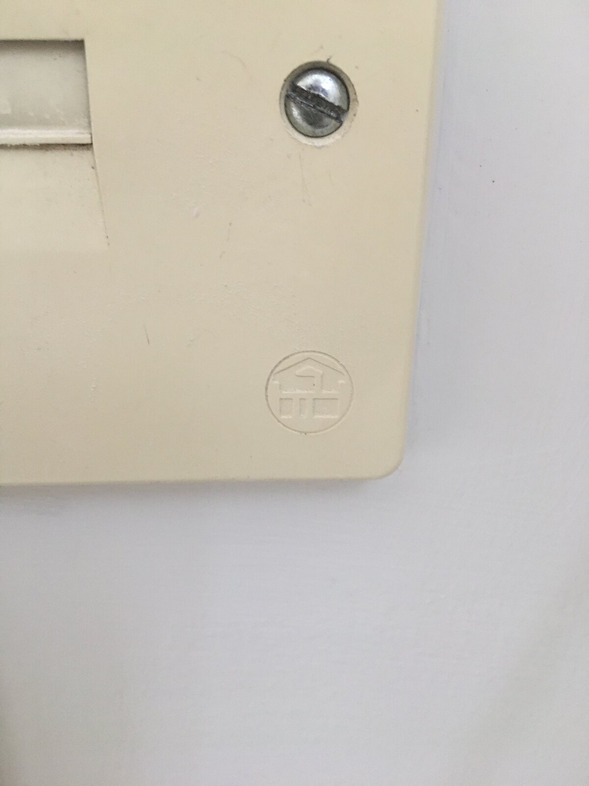

is the wiring inside that second yellowed old socket) te wire that runs out the bottom of that socket runs along the skirting up into this next picture (pic 4)
Last large photo is of a network (LAN) socket, it will have 8 pins. Earlier large photos are telephone and will have 6 pins.
I'm very surprised there isn't two little wires sneaking into the master box through this little knockout...
I would guess at one point the previous owner had two lines, maybe a fax or from dial-up internet days.
What's inside the master and what's happening outside directly behind it?
You can probably do away with everything but the master, if that's what you want, but it would be nice to move the master into the recessed back box and not have it stick out so much.
In euro modules you can get shuttered masters/slaves also, so that's not certain, I even have a few shuttered TV aerial euro modules at home.

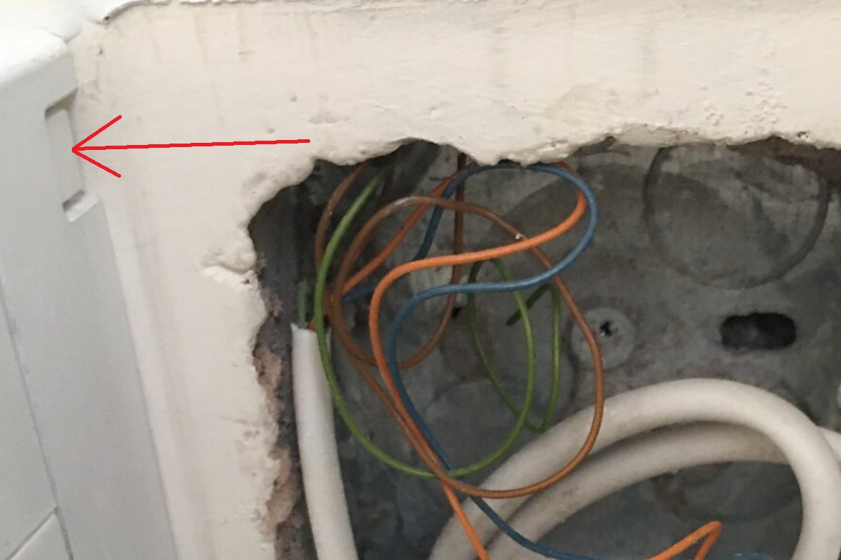

BT cable runs up and round the house and directly through the wall and into the master...i will take it to bits and get a photo - originally when we moved in the master still had a business broadband cover on it - we think this was used as an office originally as part of their business.

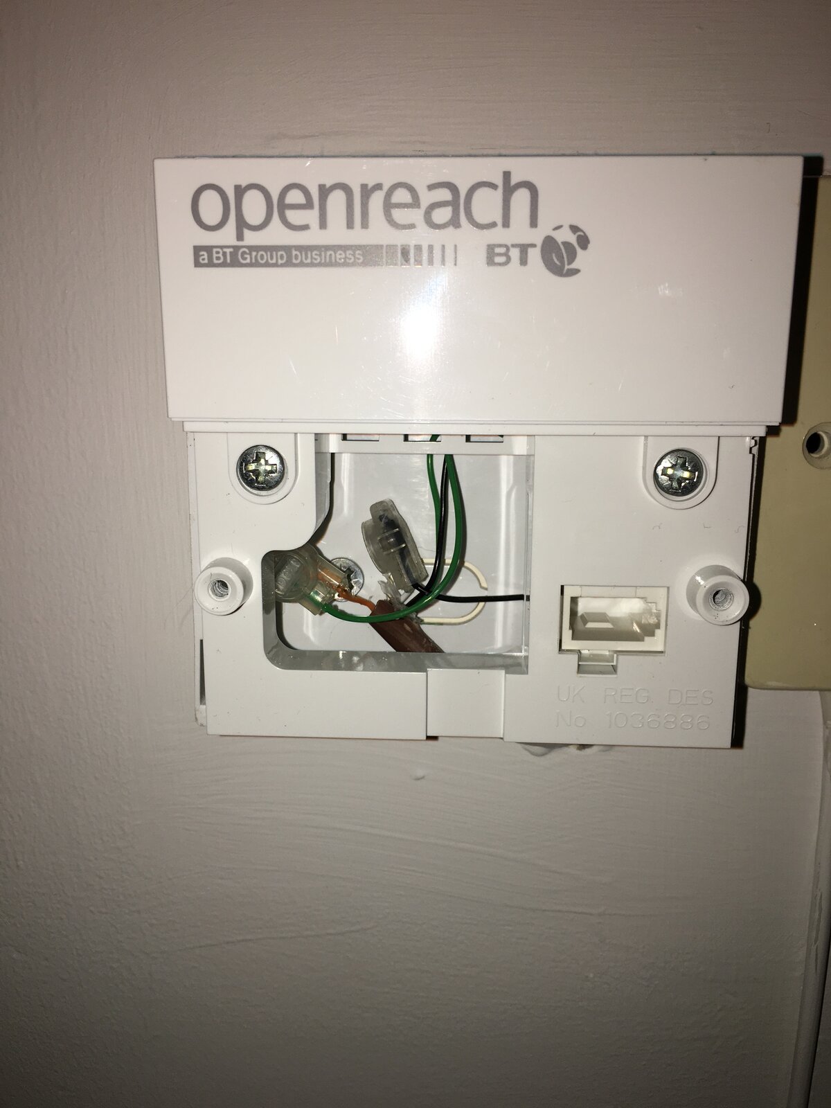

So as was suggested before i opened up the master socket. Rsgaz.....one pair of the green and black wire were cut short inside the master socket (could they once upon a time of run in through the knockout???) the other pair were terminated into the front of the removable bit where my filter currently connects into. is that all the Telephone and broadband wires are??

I don't think there is enough cable to swing round to use the recessed box for the master - i think i will just blank off, remove and disconnect the wire that runs to the Lan Socket and remove the Lan socket - two wires in that socket connected to 5 & 6 in the socket facia plate......can i test these in anyway?
I am assuming that those sockets are the terminal points not the starting points ie that the Lan socket doesnt distribute from there
Ahh, that's not correct, does the phone work in that master now, exactly as pictured, with the lower half missing?

No, if that slave next to the master is dead, then so is that RJ45 socket, and you would need a PBX adapter lead to test it anyway.
The master is a terminal point, the LAN socket is a terminal point, but the yellow slave is a midway point on the original installation when the master was somewhere else, the cables just daisy chain through any extensions.
The master has always worked so i think yes that it will do - will test that later

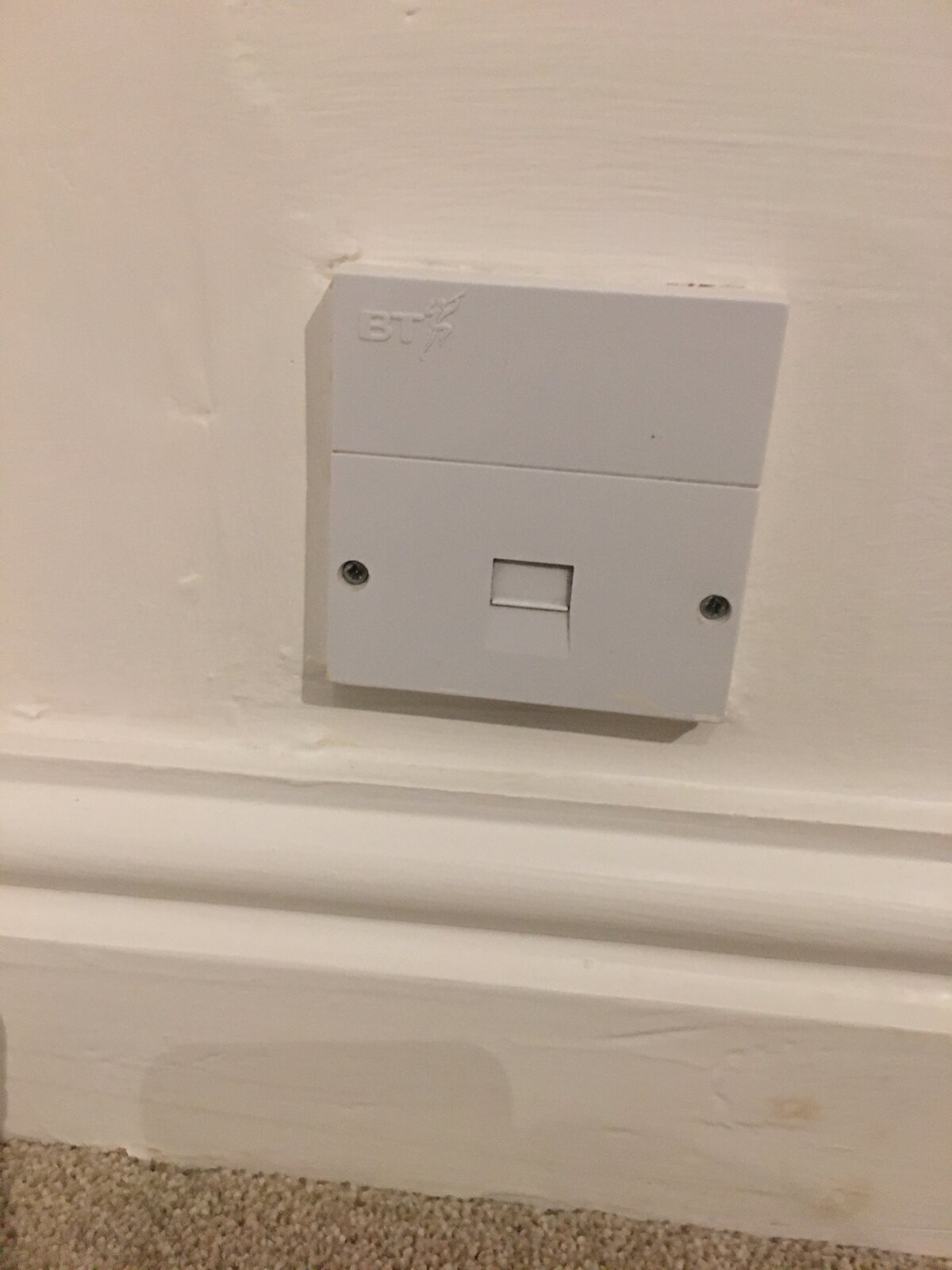

Interestingly i've now been round every other phone point in the house and none of them work - I also found this in the front bedroom
Could well be the original master, if it's an outside wall, can you see a hole drilled through on the outside, where the black BT cable would have entered originally?
Yep....The original black cable ends behind the grey service capping, from that all the little wires are connected together and run into a brown cable that runs up the wall and round and to the master socket....
what i couldnt confirm is that there is a white cable that runs in to the garage (from the hole where the black cable ends) and up towards that position of the original master socket...ill re check tomorrow to see if any of the connected wires run through the wall, but there was some resistance when pulling that white cable.
