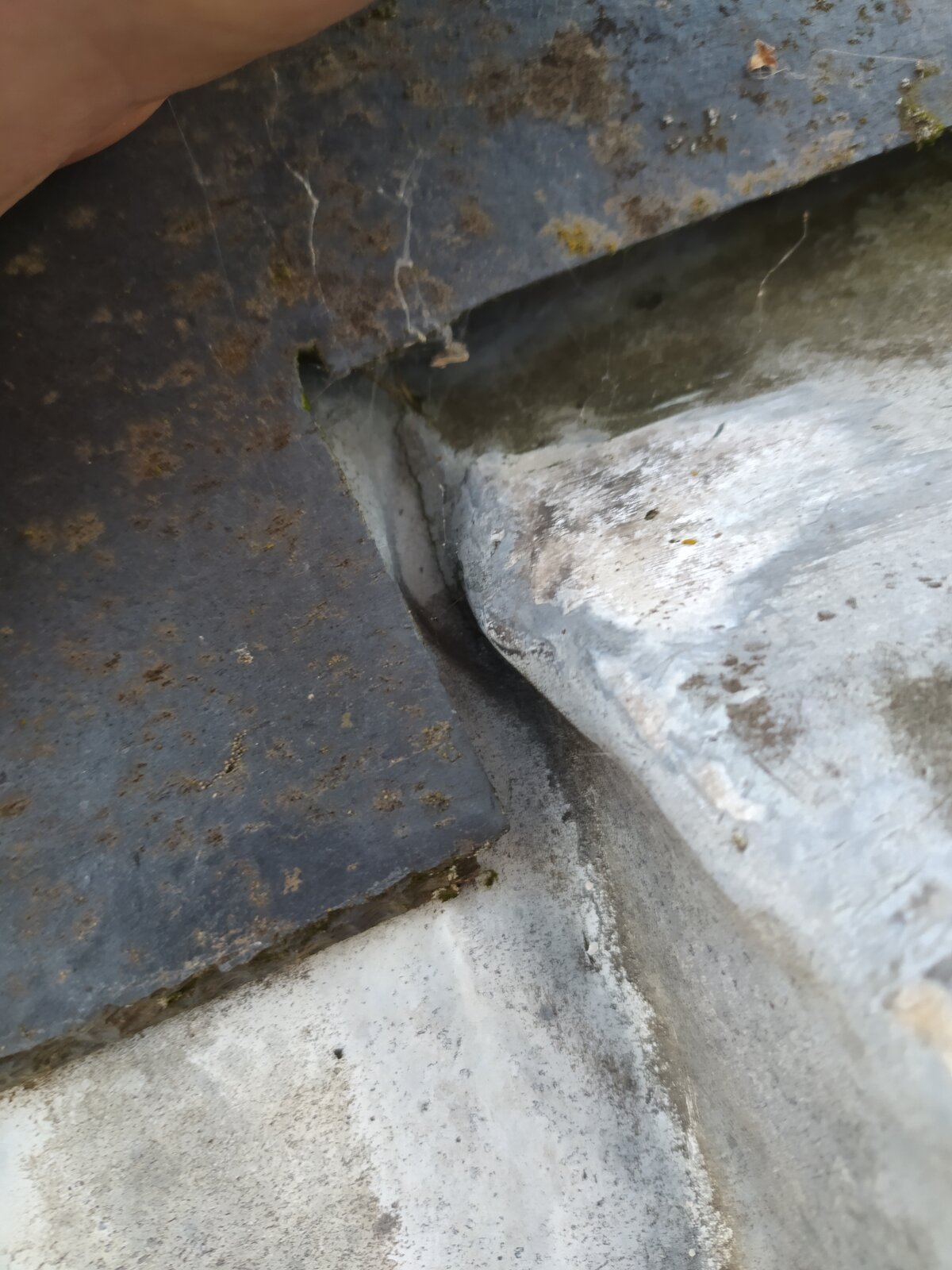

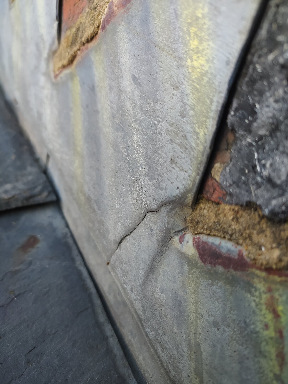

Hi all, looking for some opinions.
Got a few cracks in step flashing and small one on a fold of the back gutter.
Temp fix with a silicone / flashband combo or pony up and redo the whole lead work?
Paid to have scaffolding up, but still don't want to create extra work if not absolutely necessary.
All advice appreciated
View attachment 322325View attachment 322326
I see it's a slate roof - ouch!
If you have scaffold up , why not just do it right now ?
Most patch products are short term fixes . More so on lead
