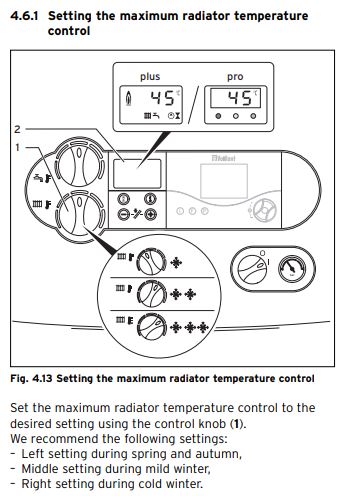

The boiler thermostat selects the temperature of the water leaving the boiler, so effectively selects how hot the radiators get. Condensing boilers are more efficient with cooler return water, so with them, it can be beneficial to set the boiler at the lowest temperature you can but at which your house still heats up fast enough. This will change as the weather gets colder and when more heat is needed to get your home up to the required temperature. Some boilers provide suggested settings in the manual. Here's an example from Vaillant.
