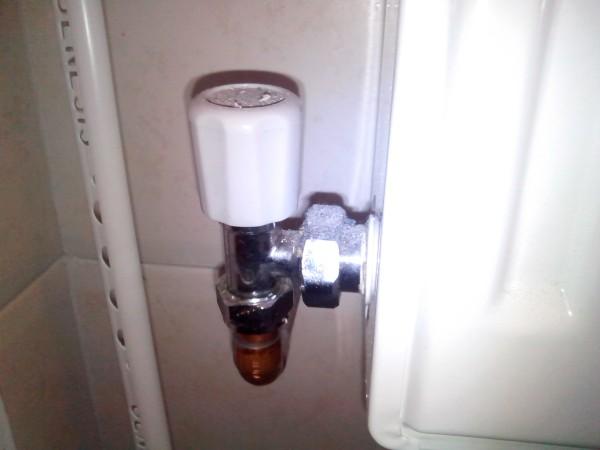

As long as you are able to turn the radiator off fully, i.e. if it has a TRV and it has a 0 after the frost symbol when turning down then you will be OK. If it doesn't you will need to cap that valve to stop water leaking out. If it's just 2 normal turn down/lockshield valves then you can turn this off fully. The CH can be run as normal.

I think it is just basic valves the other rooms have thermostatic ones - but these are smaller:
I guess this means we are good to go? Is that a drain tube on the right?
Good to go there, but that drain won't drain the rad.....crack the nuts open, open the bleed valve and collect the water in a shallow dish.
