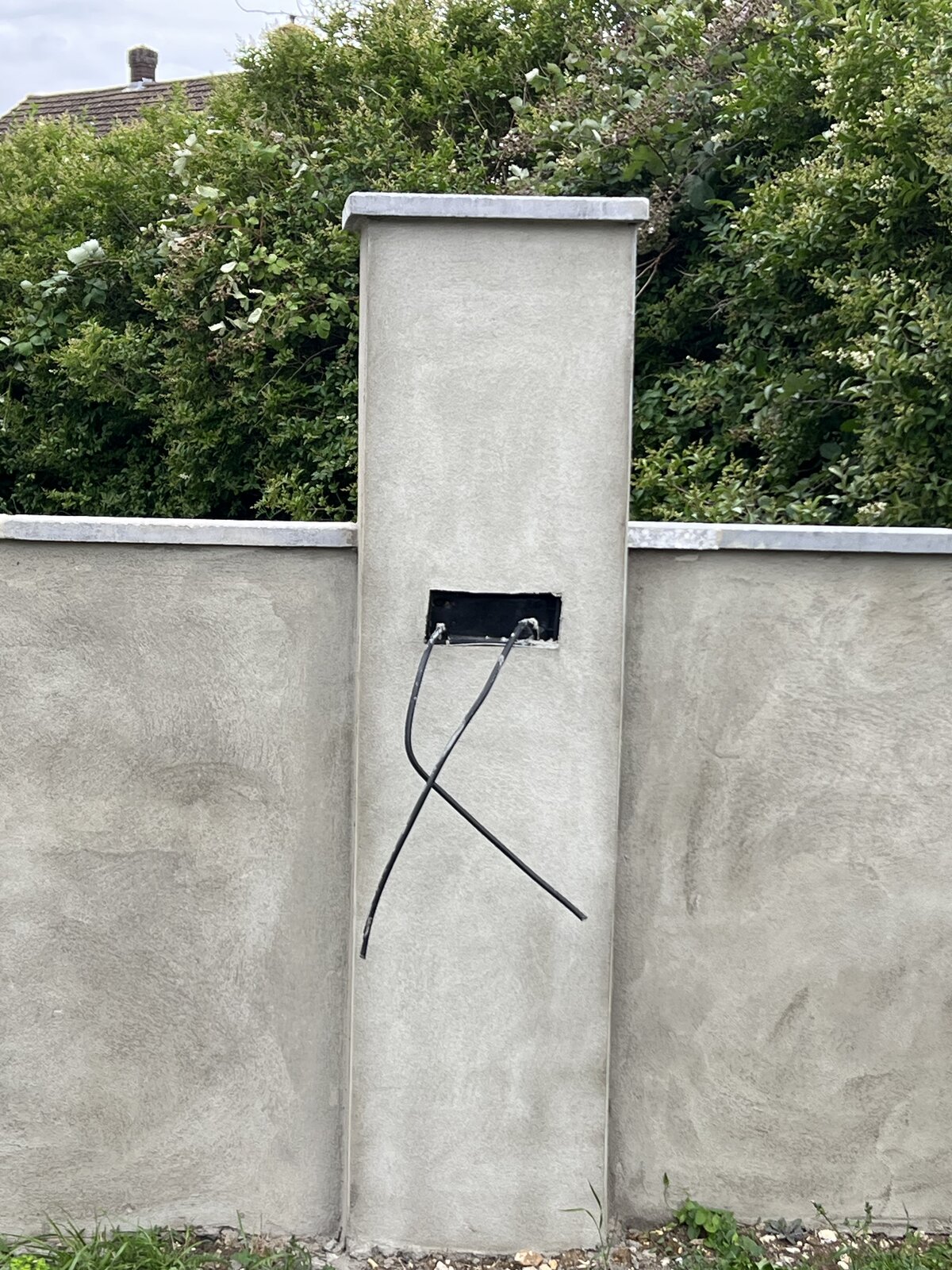

The other end goes from one pillar light to another. It’s been channeled into the boundary wall and currently popping out of the plastic back box for the light.
Yes, but the armour must be earthed at the start and the armour earth continued through your daisy chain of (I hope you have) boxes that serve each pillar light. ie two cables glanded at each box.

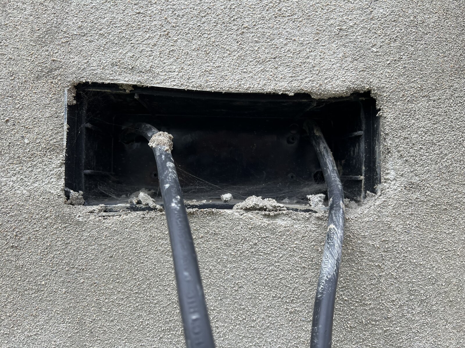

The plastic boxes for each light have been cemented in. They currently have two ends of the SWA coming out of them. There’s plenty of length on them but I think I’ve now missed the step of glanding these to the back box. Whoops.
Can I improvise?
Probably, Have you got any photographs of what you are looking at?
Here is one of the pillars:
And close-up of the box:

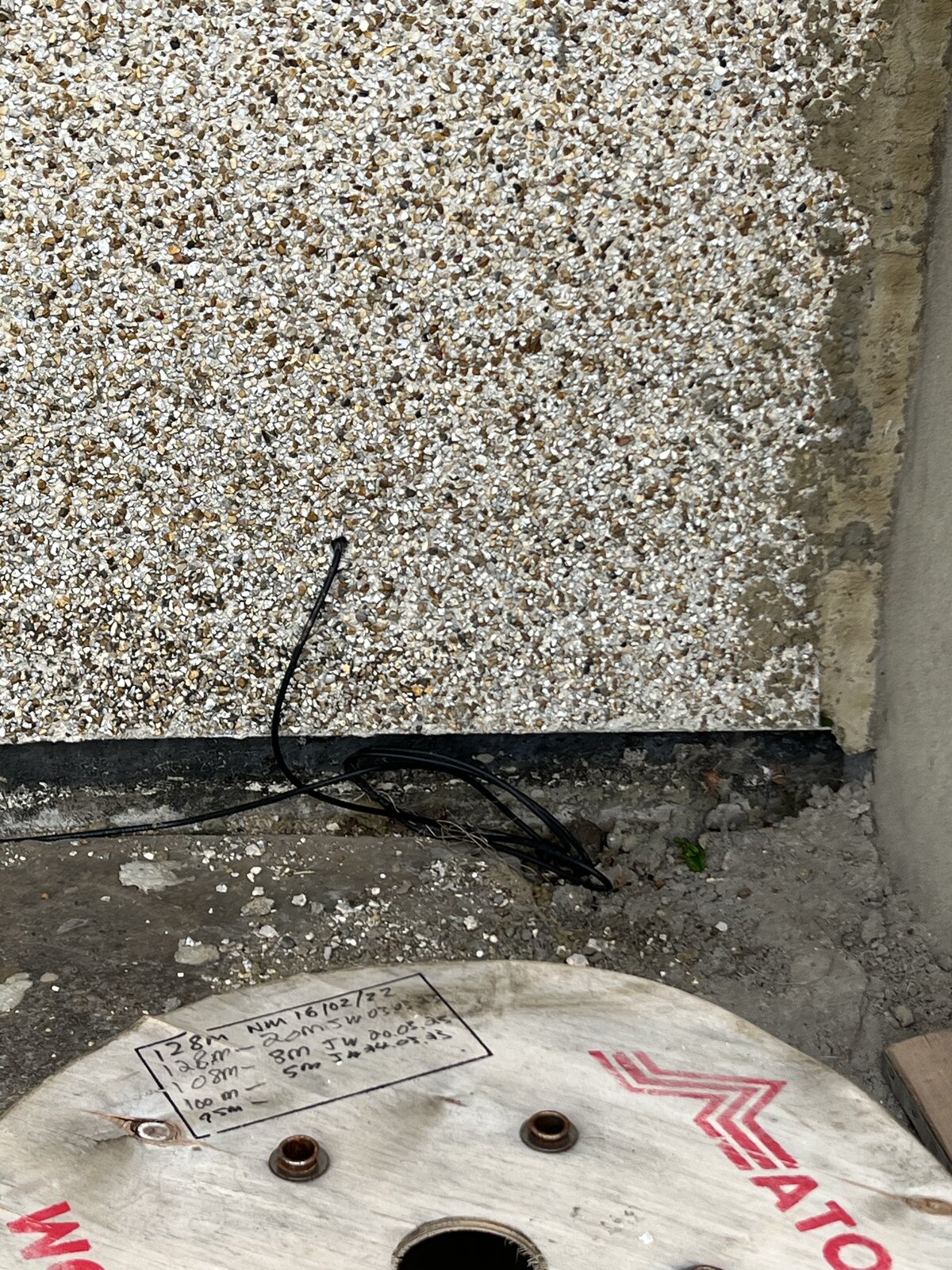

The cable will enter the house from down here (current cable is for phone) and have a FCU inside.

If those back boxes are plastic (which is non conducting) then glanding them to it does nothing, you need to be ensuring that the earth is continuous through the entire circuit.
While I'm sure someone will tell you about a product to do it, you may now have to put each end into a brass gland and use banjo's and a length of earth wire to join them both together.
So why don't you give the information about other methods?
Brass glands are not the only method, it is permissible to treat the steel wires like any other wires, twist a few into bunches, sleeve and terminate.
As an example:
Another purpose designed product for the job which will likely be easier within your restricted space:
