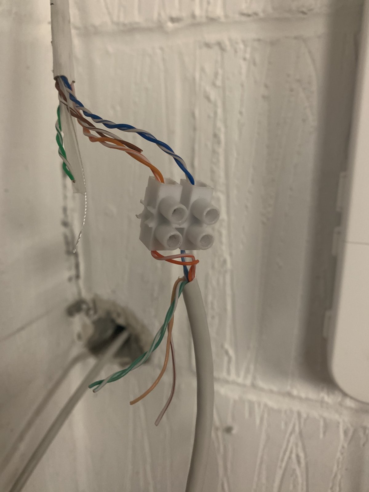

Sorted! Found that the bell cable was running into the garage. Pulled it back into the garage away from the bell push and have extended it and pushed it back through. All working!
I didn’t have any bell cable so just used some CAT 5 cable - is this OK? Or should I replace with some proper bell cable?
Many thanks.
Or maybe the original installer had used CAT cable anyway? See pic, the cable in going into the top of the bloc is the ordinal and at the bottom is my extension... obviously I’ll tidy it all up...
The top cable is cat6. Pretty much any cable at all will be fine for a bell push.
Thank you. But since I’ve used cat5e to extend the cable, is this ok/safe given this it’s coming from a 240v chime albeit with a transformer? Many thanks.
Yes it will be fine as your doorbell unit will contain a transformer which reduces the voltage to about 8V at the bell push.
