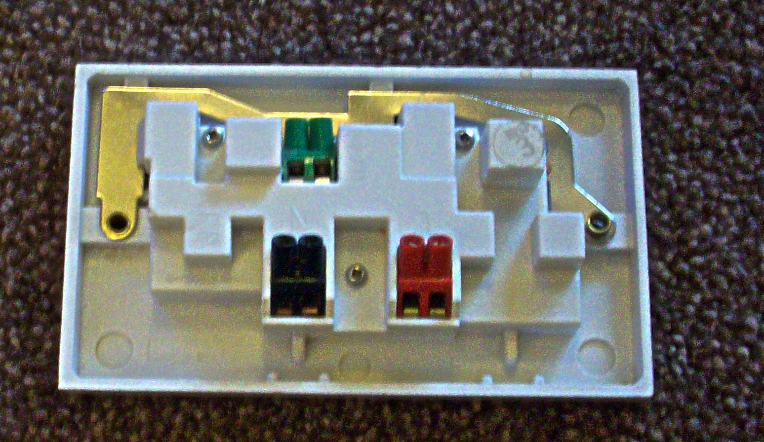

... however in industry there is an unwritten rule, one terminal one wire, what we do with a ring final putting up to three wires in one terminal would not have bin allowed.
It's not an unreasonable 'unwritten rule'. I'm a little surprised that we have not seen the evolution of ones like this (perhaps even with groups of three terminals, to accommodate spurs) (apologies for poor piccie!) ...
Kind Regards, John
