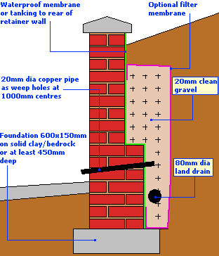

Please can I have some advice as a gardening novice. I have a back garden that slopes up away from my house. At present there are concrete steps leading up the middle and each side is grassed. The layout is slope/middle flat bit/slope/bottom flat bit/slope. It makes mowing the garden tricky to say the least. The garden is approx 40' wide by 50' length.
If I tried to put walls where the slopes were could I use the decorative concrete blocks - or would they not be man enough? They would need to be approx 3' tall
Would I need proper foundations? If so to what depth?
Is this a job for a complete novice or would I be best advised getting an expert in?
What else can I do to make it as maintenance free as possible - would the cost of patioing the flat bits be prohibitive?

Does this help to give you some idea?
Thank you to both Thermo and masona for their help. The project continues!
Sorry - not sure how to upload photos - but if you imagine the water slides that undulate (though not as steep obviously!) that's what the sloping is like. I thought if I could get rid of the slopes by building a couple of little walls, I could then progress to perhaps putting slabs/chippings on the flat bits - ideally a maintenance free garden!
