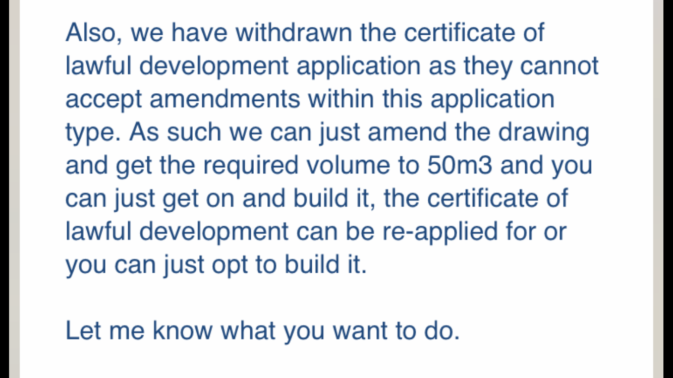

Today I received my decision notice from Lewisham planning department unfortunately I've been refused a Certificate of Lawful Development for a loft conversion as the sky light on the flat roof was protruding beyond the highest point of the original pitched roof (~10cm). This wasn't really something we had specifically wanted in fact we wanted a flat skylight instead of a crappy plastic dome but was nevertheless in the plans. My annoyance is not really because of the decision (which was correct according to PD rules) but the fact that we were not given the opportunity by the planning officer to change this tiny detail we didn't even care about. It took the architect 5 minutes to amend the diagram, instead we waited the full 8-weeks without a dicky-bird from the planning department then (4 days late) we got the refusal. We could have resolved this minor issue early in the process, I can't understand why this was left the last day of the 8 weeks. Is this normal?
Also does anyone know what I can do now? Wait another 8-weeks for them to OK this pathetic change? Can I complain with any hope of getting it decided sooner?

A LDC application does not allow for discussion and changes like a proper planning application.
The applicant presents something and basically asks "Is this lawful". The council assess all the information that is presented, and then say "Yes" or "No". It's that simple.

No. That's not the way LDC's work.

This is the professional who said I 'needed' the LDC, then draws the dormer at 55m3, withdraws the application to save getting it rejected then tells me I don't need it anyway.
Excuse me, I've been on the Bacardi, but the same guy ****ed up, asked for £300 to correct his **** up, then told me he 'isn't running a charity' when I tell him I shouldn't be paying for his mistakes.
