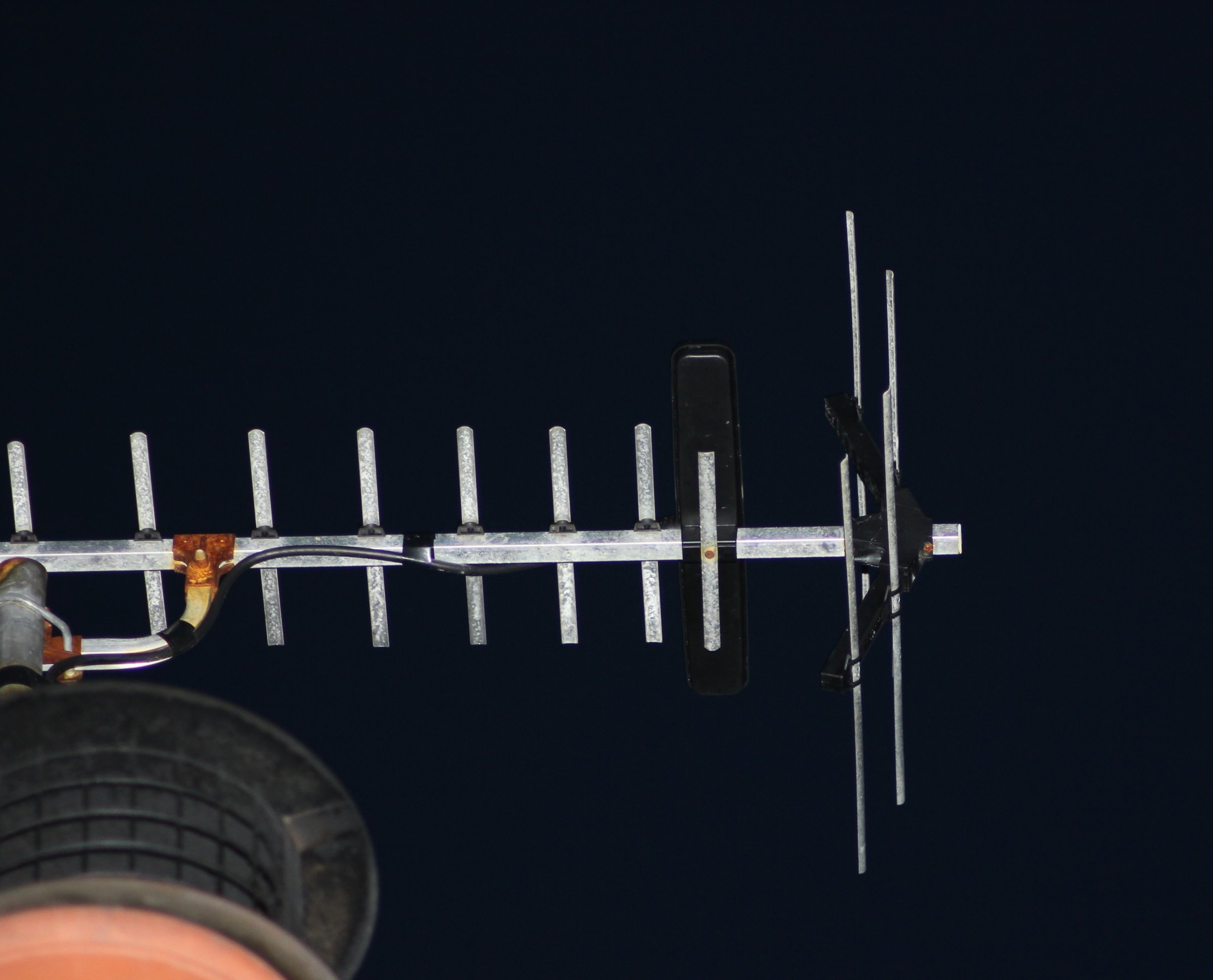

This is my aerial, I guess it's a wide band. Just looks like a bog standard aerial from yesteryear.

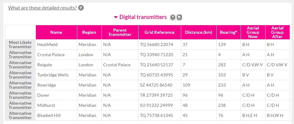

This is my result from: http://www.digitaluk.co.uk/coveragechecker

So you are on Crystal Palace (the only one with London Live). The frequencies used for CP are as far away from 4G as you can get so another reason it is not 4G interference. Any filter will introduce a slight loss so your London Live must have been on edge. Having said that your other signals must be near the edge as well and dropped over for a time.
I still suggest you try removing the filter and see what happens.
Your picture of half your aerial does not help. Any sign of 4G filtering will be at the very front which is not shown.
Do you know which transmitter you are pointed at? You should be able to work it out from the stored channel numbers (not the station numbers like 1, 2, 3, 4, 5 etc, but the frequency channel, 21-68 (61-69 now 4G).
