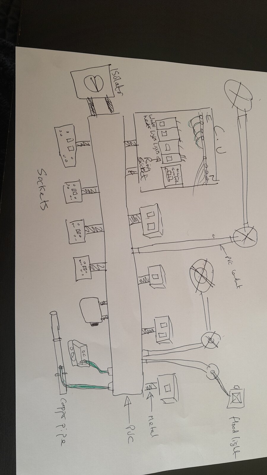

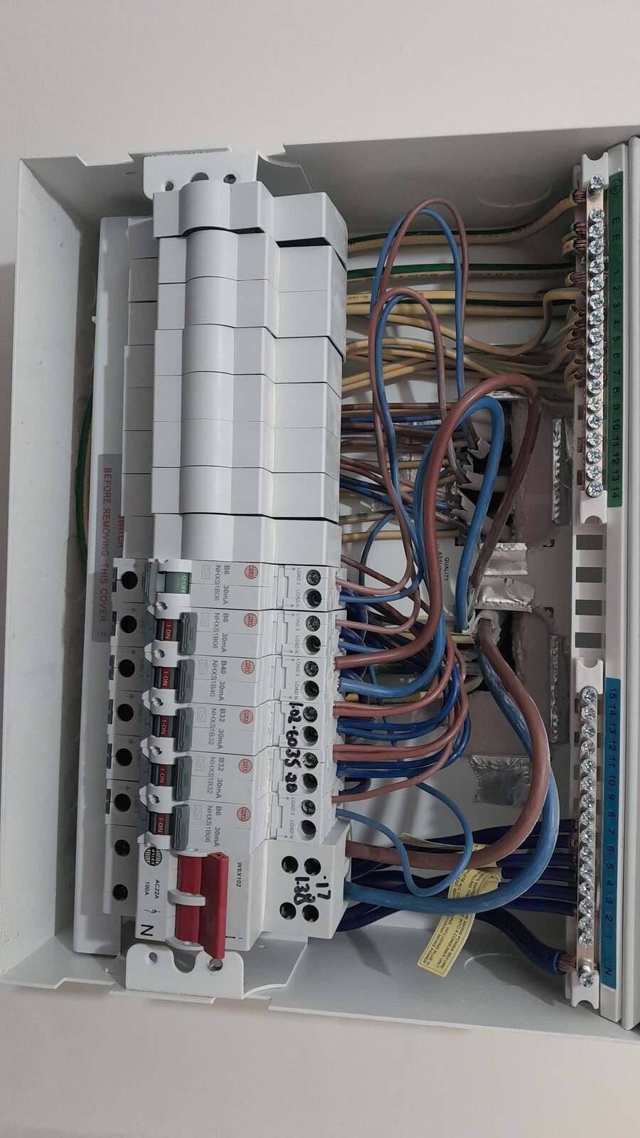

Hello good people
I haven't worked in the industry and I have DIY experience.
I am studying the course at York college.
I have a practical exam coming up. So i just want to get some practice in beforehand. Got a couple of months left yet.
I've made or should I say attempted to make a little sketch of the board will be.
The consumer unit will have RCD protection although this board doesn't seem to have it.
Can someone please kindly walk through how to do some of the tests. Especially on rlthe ring circuit.
Ofcourse once the safe isolation is done... I've turned off everything. Etc etc.
I'll perform the dead tests and then move onto live tests.
My idea is start off with continuity . Link
Cpc to live at breaker. Check all lightings etc sperarely switch lamp. Then move onto the heater .
Repeat with line and neutral.. how would i do the ring and bonding and the metal tray? ? Would it be long lead method?
Then once that's done. Move onto Insularion resistance at 500v. 3 tests on each circuit.
Then live and rcd. I've not really done this before. I'll need to read more on this one.
Any help would greatly be appreciated.
Follow the CRIPPLER method.
C ontinuity of cpc and bonding conductors. R2 wander lead.
R ing continuity.
I .R test
P olarity DEAD test
P olarity LIVE test
L oop impedance test, Ze and Zs
E arth fault and PSC fault current
R cd and other functional tests. (Ramp tests etc).
The practical at college should guide you first and you'll normally get a demonstration then they will ask you to do it just before the exam.
To test a ring circuit disconnect the 6 conductors from the board,
test continuity ,
live to live,
neutral to neutral
earth to earth
record the results in ohms, the live and neutral result will be similar and the earth result will be roughly 1.67 x the line and neutral result (assuming 2.5mm L and N and 1.5mm earth)
Then connect live 1 to earth 2 and live 2 to earth 1 creating a figure of 8
Then go round to each socket and test between live and earth, this result will be recorded as your r1+r2.... also this result should be a quarter of the live loop and the earth loop you did at the start added together and divided by 4.
When testing at each socket the result should be roughly the same which should mean the sockets are part of the ring.
I'll await my bashing...good luck with your course mate.

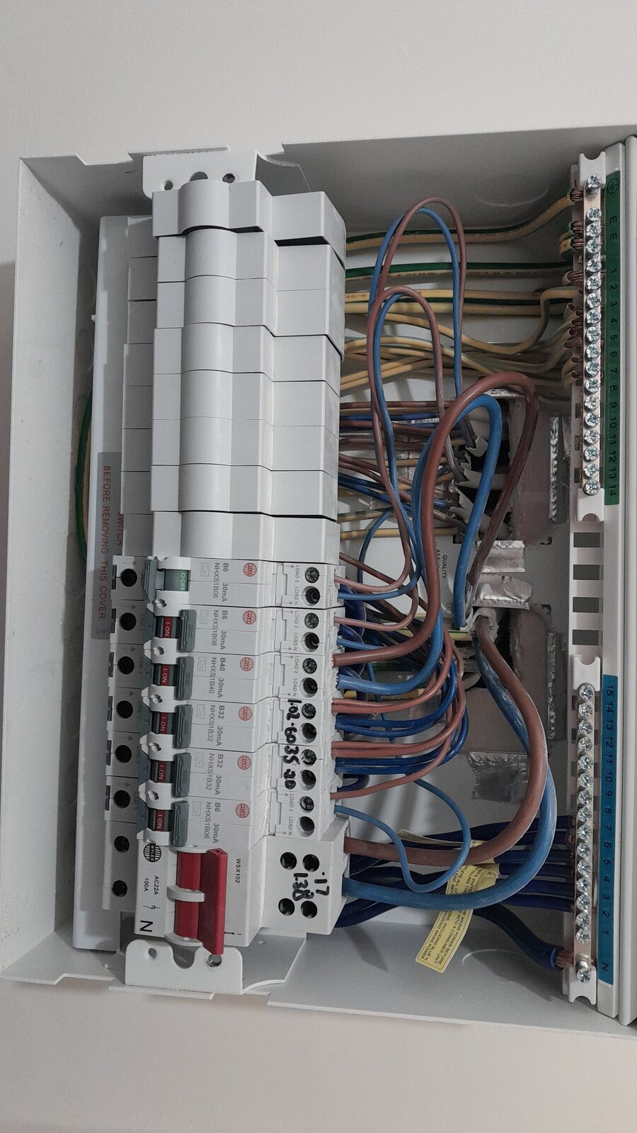

I live in a flat. It says its protected by and RCD.. but I can't see the button . I'm assuming it'll be in the main consumer unit for the block ?
Judging by just looking at CU opened . It seems the kitchen sockets and the general sockets have 2 seperate rings as they have 2 sets of lines and neutrals coming into the MCB. And correct me if I'm wrong the larger neutral wires coming into the back of the MCB from the RCD ???
I might do some continuity tests.
Be a bit careful mate, if I was you I'd probably mock up 4 or 5 sockets on a board just to get the hang of it.

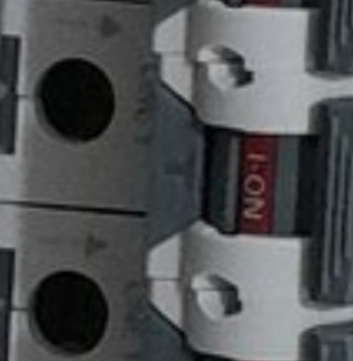

The rcd test button is marked T
