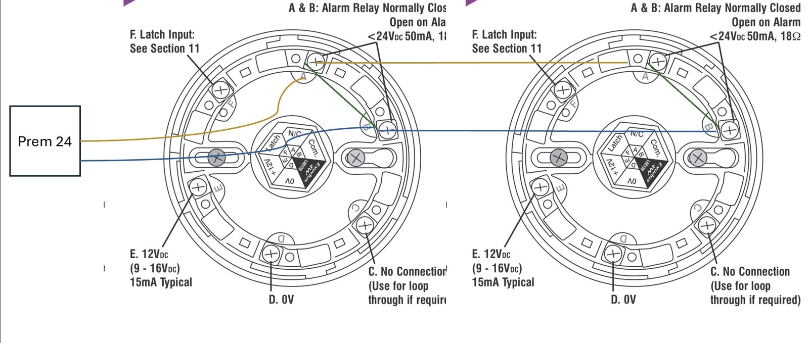

Good afternoon,
I am hoping to achieve some assistance with an issue I face connecting two Exodus OH4Ws to my Prem 24.
1. Zone (8) is set to Fire
2. Zone is set to Normally Closed Wiring
3. 12v supply in parallel is operational with no issues
4. Wired in series from the zone terminals, to A and B on both detectors. Illustration attached to avoid uncertainty.
5. I have tried it in parallel too with no luck.
6. Multimeter shows continuity in normally closed, but can’t single handedly check value when in test mode as not using latching.
7. If I need to use resistors can someone advise which terminals which resistors should bridge, each for the first detector and the second detector.
Thank you for any assistance!
